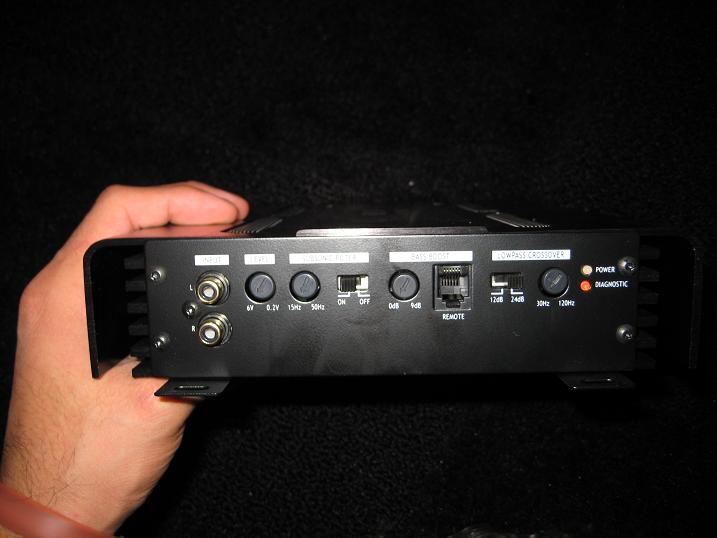

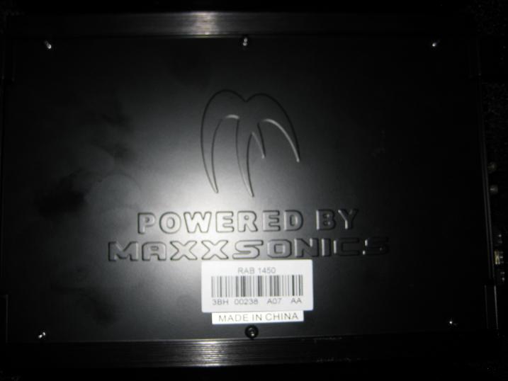

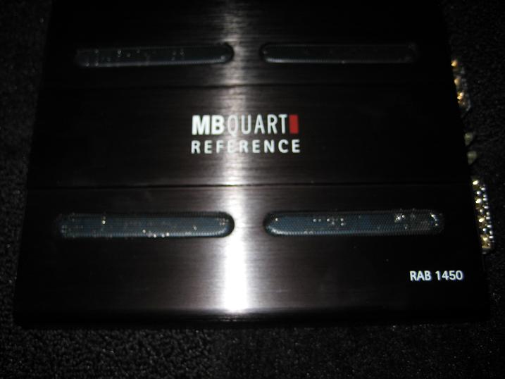

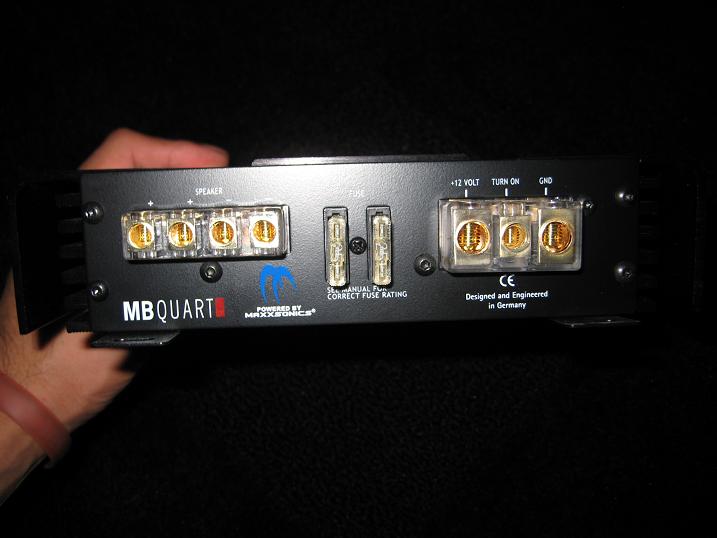

    Would you take some incredibly detailed shots of the amp? From what I can tell, it is the same manufacturer as the Titanium Power I sell. What did you pay for it?
          I almost shit myself a couple times thinking that bit would fly into my eye.
          attatched a couple pics.. camera sucks. Paid 110..free shipping. I got the last one off the website though. Says it's on backorder now..

                    Alright.. I got everything wraped up however the sup wont fire. Im not sure if it was to do with the HU settings or the AMP. The amp itself turns on (power led green) however I get nothing from the sub. I did notice I have a factory amp while the tear down..anything to do with it? My 4 speakers play just no sub. I did also notice the variable knob adjustment has a "power" led which remains off. Checked my connections from sub-amp = ok. I wired stripes to negative... soilids to +. I also wired from my amp on the 1st positive terminal, skipped the 2nd positive terminal and hooked up to 1st negative terminal)from left to right) ..any help? It has to be something retarded.
                              Wait....if you are bridging the amp, shouldn't you be wiring it:
                              this way:
                              x_____x
                              not this way:
                              x___x__
