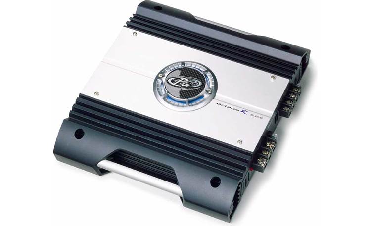

                          You are going to want an active crossover for them. I dunno, though. For the price of the active crossovers I'd rather just get a smaller amp to power them separately. Most if not all amps produced now have built in variable crossovers.
                          Check this one out:
