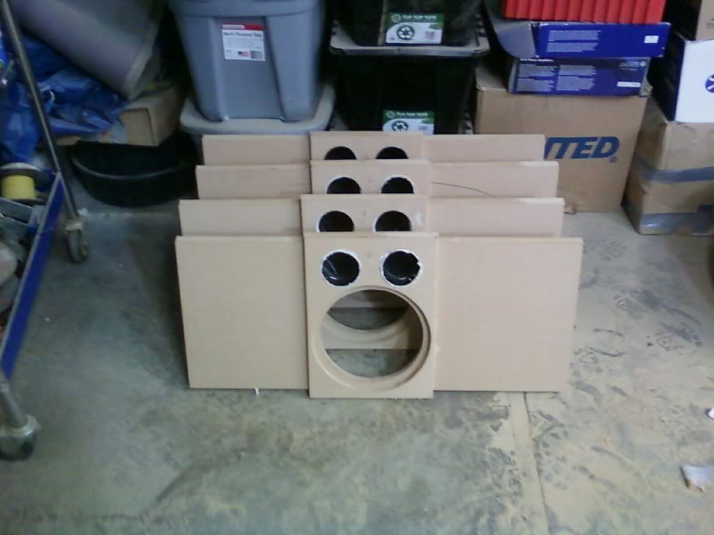

Spent quite a bit of time drawing things up in NX5 and tweaking here and there. It was quite the process of getting a whole lot into a small space.
I worked it out to be a gross vol. of 1.56ft^3 and with the maximum port length (39in) I get about a 1.08 net volume. Using 4in PVC puts me right around 27.5hz , being the lowest I can go. Im thinking I can build it and play around with port length until I get it sounding exactly how I want it.
I still have some fitment issues to work out with the magnet hitting the bottom of the box but I need to actually get the mag diameter to do that...
Also I need to measure the actual space in the trunk to figure our how big the "faceplate" thing needs to be and where it goes. Tell me what you think:
That won't fit.
There isn't room to fit a 4" port and a 10" woofer in the opening of the ski pass.
Nice try though! Look at this pic, see how crowded it is already?
Well, check this out:
Yeah, there is plenty of room on the plate, but none between the woofer and ports, and then again no spare space around the hole of the pass through...getting the ports and the woofer on that panel is a squeeze.
Another thing you might wanna think about is the placement of the end of your port tube inside the box.
The opening being perpendicular to the face of the woofer is like blowing across the top of a bottle.Comment
