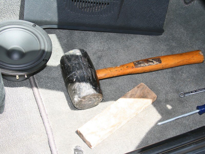

        Today's update:
        I got the front woofers installed. This was a real bitch. The speaker pods are part of the door jamb, so you really cannot pound the metal out much unless you don't plan to open your door all the way. I plan to open it all the way, so I pounded it out as much as I could without interfering with anything. This bought a few millimeters.

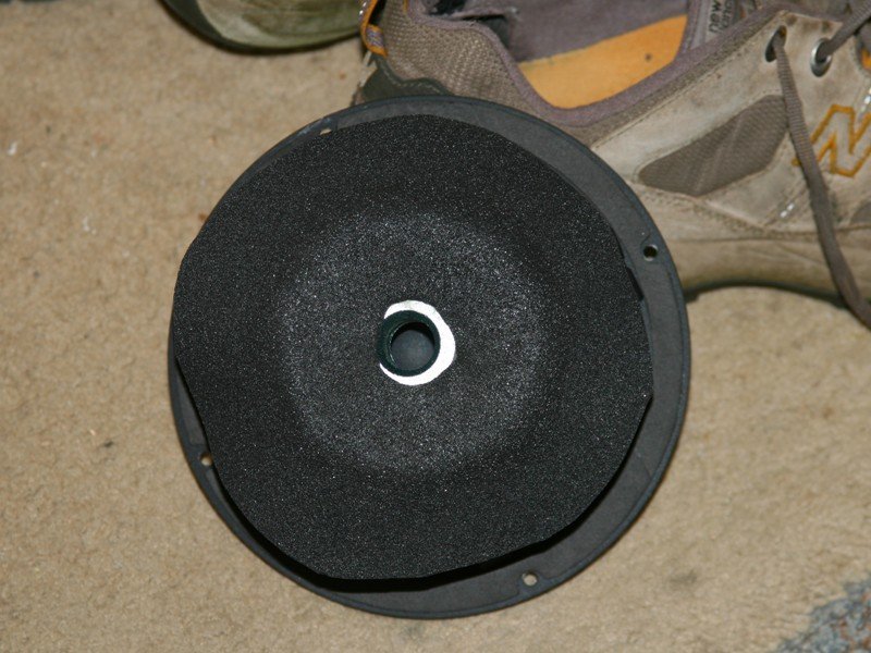

        The rear of the pole piece does contact the back of the pod when installed. To avoid buzzing and scraping problems, I put some 1/8" closed cell foam on the back of the drivers. They don't sit completely flat in the back, so the pole piece vent is not blocked off. The foam piece is glued on so it won't go "walking."
