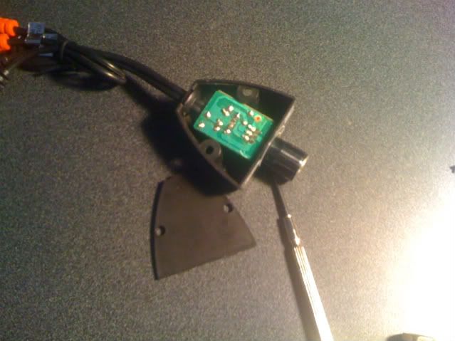

    So I ordered one of these from sonic:
    for $15 shipped with the intention of mounting it in one of the blanks above the radio in the dash. The good news is that the controller comes out of the casing easily:
    The bottom pops off with a small screwdriver.

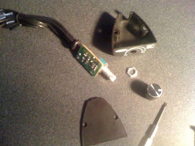

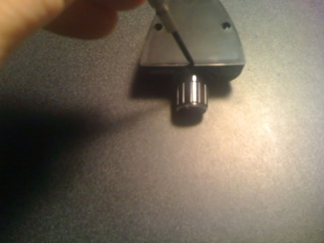

    the knob is a pretty standard affair and comes off easily

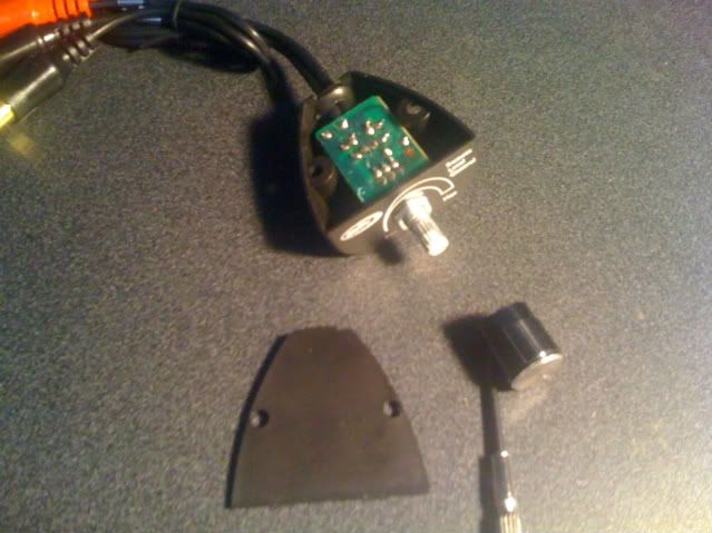

    the controller is only held in by the retaining nut on the shaft, and the friction of the grommet around the wire at the rear.
    Now to drill a 1/4" hole in a dash blank and install
