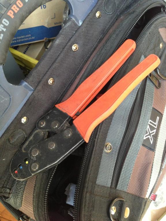

For uninsulated crimps, I found a great hand crimper made by Molex. Part number 63811-1000. Insulated crimps are trash to me. Digi-key has them for $35 or something, and it covers almost every wire size except for battery cables and large ground straps. Makes as perfect "B" type crimps as you can reliably do with your hand.
