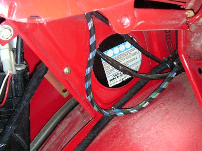

              Is this the Stock Amp in the trunk beside the power antenna? (E30 318is)
              If that is the amp, then I'm pretty sure it has premium sound, as the tweeters are stock in the corners of the windows.

                  You do have the stock amp in place: your pic shows it. Whether or not is is connected is another story.
                  The easy test is to unplug the amp while the stereo is playing.
