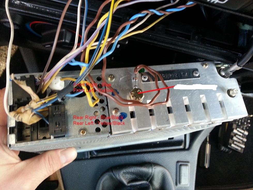

      The posts I'm reading about using stock wiring and common ground system was causing problems for people on premium sound. People are running all new wiring to each speaker for better results. Just getting conflicting info so don't know which direction to go for my install. After I get mine working I will post more install pics to add to this thread.
      So for my setup below I only have a LF+ and RF+ (No LF- and RF-). Do they come together as 1 Ground back in the trunk area as a common ground? I'm going to take out the trunk lining tomorrow to see if I even have an AMP and what wires are going In and Out. Also noticed the wiring harness provided by the Pioneer head unit has really small AWG wire. Nowhere near the stock wiring size.

        Oh lord, I really do get tired of explaining this.
        E30s are NOT common ground.
        Post your year and model AND what stereo came in it stock, R3V will help you figure it out.
        For example, that looks to be a late model, non premium wiring.
        See where the brown wire twists with the blue or yellow? Unwrap that harness about a foot, you will see where all of the wires become twisted pairs, one pair per speaker.
        From there, it is pretty easy to figure out which is which, just remember that the black stripes are positives for the rear speakers.
        If you have premium sound, you will find an amp in the trunk, just in front of the antenna, on a bracket with the check panel diode pack. Don't fuck with the check panel wiring, you will regret it.

          i have the premium sound deck and tweeters but no premium wiring? that's odd.
          I have a 1991 318is, no fader, Head Unit is CM5908. It has rear premium speaker deck and tweeters.

            OK, so right here is a perfefct example of WHY I always ask what year/model/stereo. Your wiring is '91 only, as far as I know.
            You have the easiest of all E30s. You can bypass, amplify, power the rears from the deck with amp power on the front, all of the above.
            Its all easy, follow the directions I already posted.
