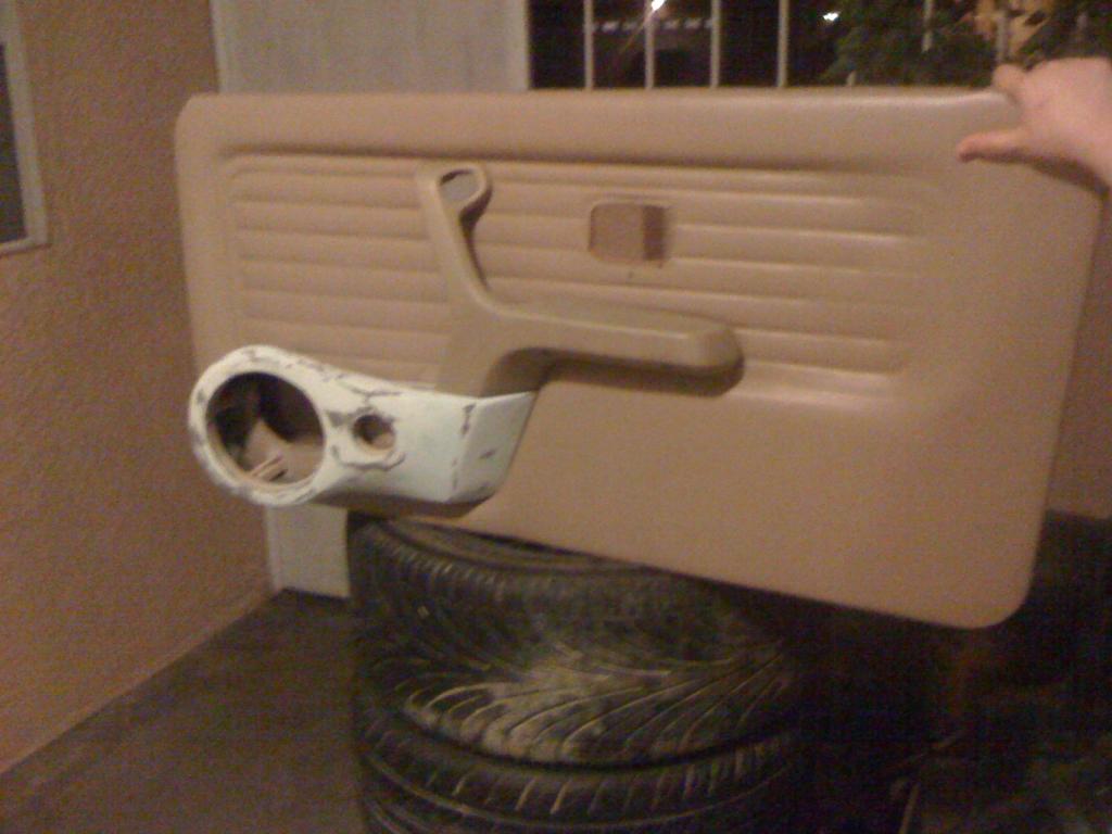

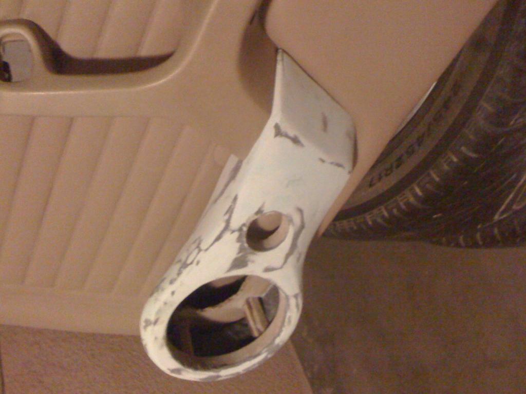

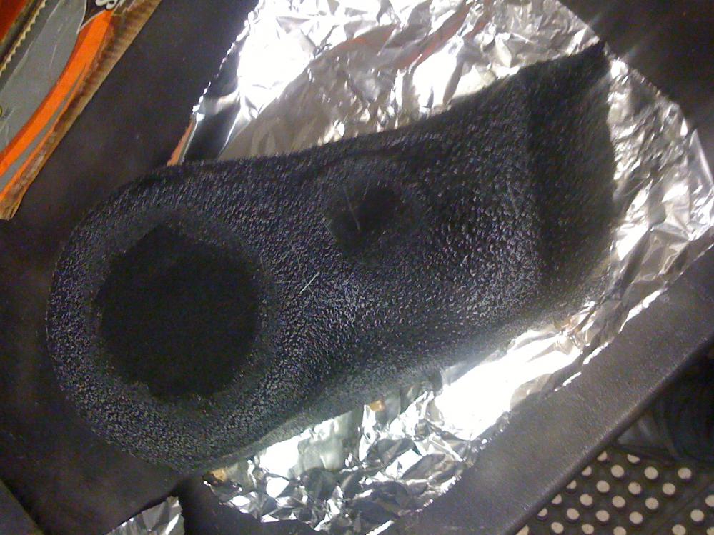

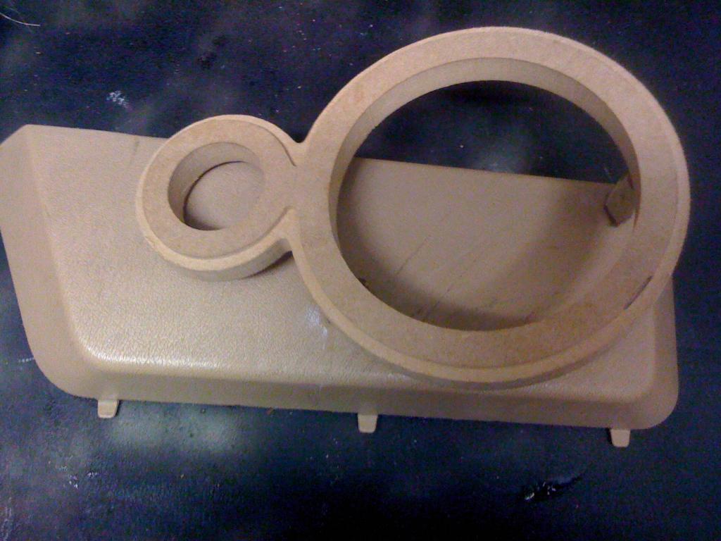

    This is my first attempt at fiberglass and so far its looking good. Thought adding speakers to the doors would be a nice addition to a vert. Here are some pics of what I have done in the last couple days.

    more

      How it looks right now, needs a little more work

        Wow, nice router work! CNC or templates?
        I hope you aren't planning on trying to keep that sealed...you will get zero bass if you do.
        If you don't wanna cut into the door, read up on "aperodic" designs or consider using speakers intended for tiny sealed boxes...but no way to run "normal" car audio component speakers in that airspace.

          one more

            How close are those to your legs?

              ah, you dropped more pics as I posted
              Not sealed, I see.

                Personally, I would never put tweeters firing into my knees...
                  Templates, its not sealed though. I havent closed the back of it, what would you recommend?
                    Its close, but not that close. Like luke said, I messed up by putting the tweeter too close to the knee area lol

                      If it is open, you should be fine. Shame we don't get the space of an E34 up front:
