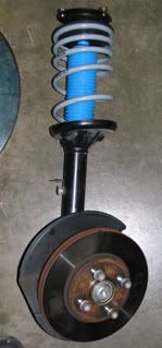

                      Yep, sure did see how ya made them. Still looks pretty time consuming though. I studied that post considerably :). Unfortunately I often work late enough not to give me much time to 'glass and sometimes only have one weekend-day so my time is pretty limited. I am still planning on getting new suspension on my car, and a new headunit/amp/speakers etc which would probably eat up all my time right to the point when I should be leaving anyway. Right now I am working on this --
