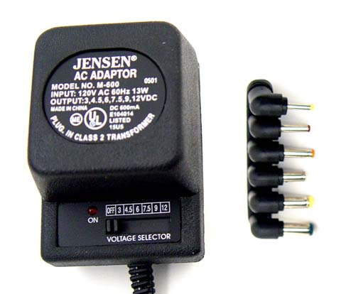

    Take our voltmeter and set it to 20DC volts. Now put one plug to a ground and now use the positive probe to touch a red, yellow, orange, ect wire in turn and write down the result. When you have what you need I recommend extending the lines and adding a quick connect to it. For easy work later. I also recommend spending 3 more dollars at HF and getting a set of gator
    clipped wires. Great for this sort of work, and at that price, you can always canabalize them
    for projects.

                ^Why not use one of these? Maybe with an inline fuse holder?
                • MaksV
                  • 1042
                  You can.... but a PSU maybe free/handy and its a good learning experiences with a small safe electronics project.
