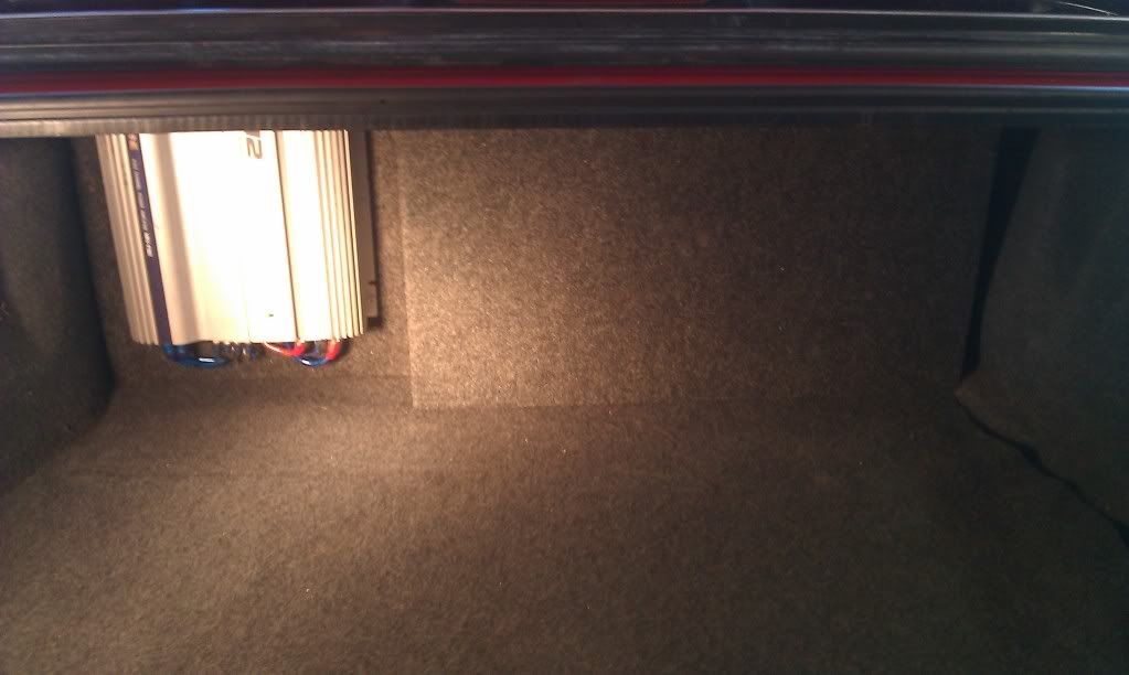

                A single 10" and 1 of my boxes is under $300 shipped to your door. Add a $100 amp and a car-full of good condition stock Premium Sound speakers or Infinities or MB Quart or whatever 5.25 component kit up front, then whatever crap you can find for the noise from behind your head...keep in mind with the system I am describing using the 4 channel, you will have roughly 80 watts to the front speakers, roughly 25 watts to the rear speakers and 180ish to the subwoofer, which is amazingly efficient and will play damn loud on 140 watts...so plenty of bass, with extraordinary clarity and depth and excellent SQ.
                Sounds like it would be roughly $600 total, right?
                This setup is what generally resides in my own daily driver, although today it has the 8" box and the little POS Alpine I have, which is not as good as that 4.60.
                Here is a pic of the 8" box and amp setup:
                and here is a typical 10"

                        Actually, the 8" version can be made to be easily removable, that is one of the design goals. Besides, it weighs so little it would not be why someone lost...
                        My personal fav deck right now is the Pioneer DEH6300. Great features, great color match, not too hideous. Cheap, too, roughly $120.
                        I just did an hours drive at 70ish speeds with the windows down listening to Sublime. The little 8" box just flat gets it, the thing is amazing! Every time I see how tiny the thing is it just amazes me how good the bass is.
