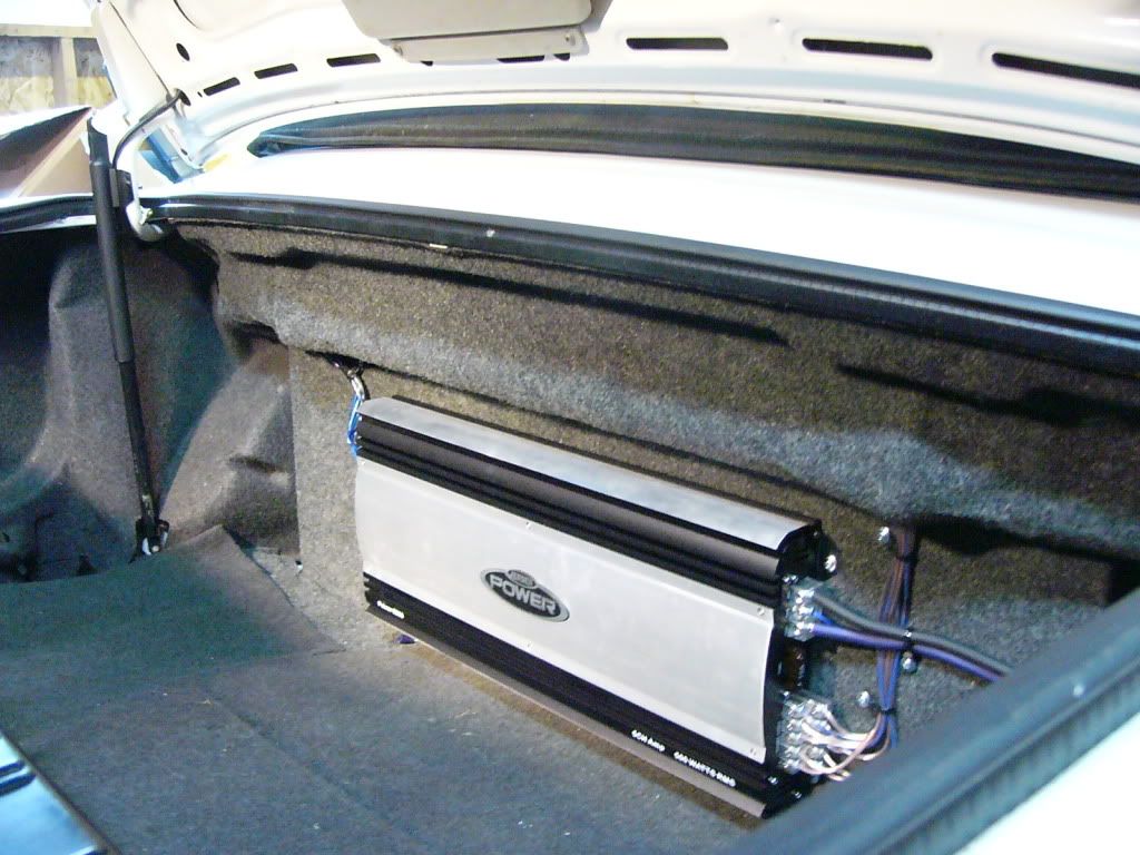

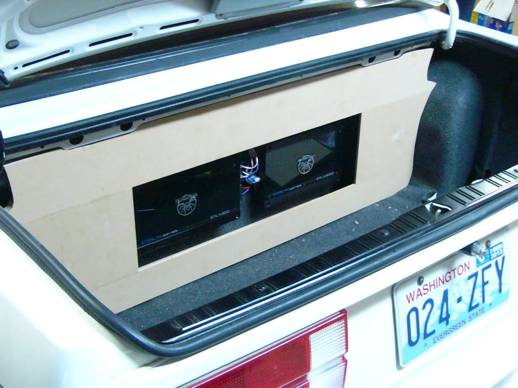

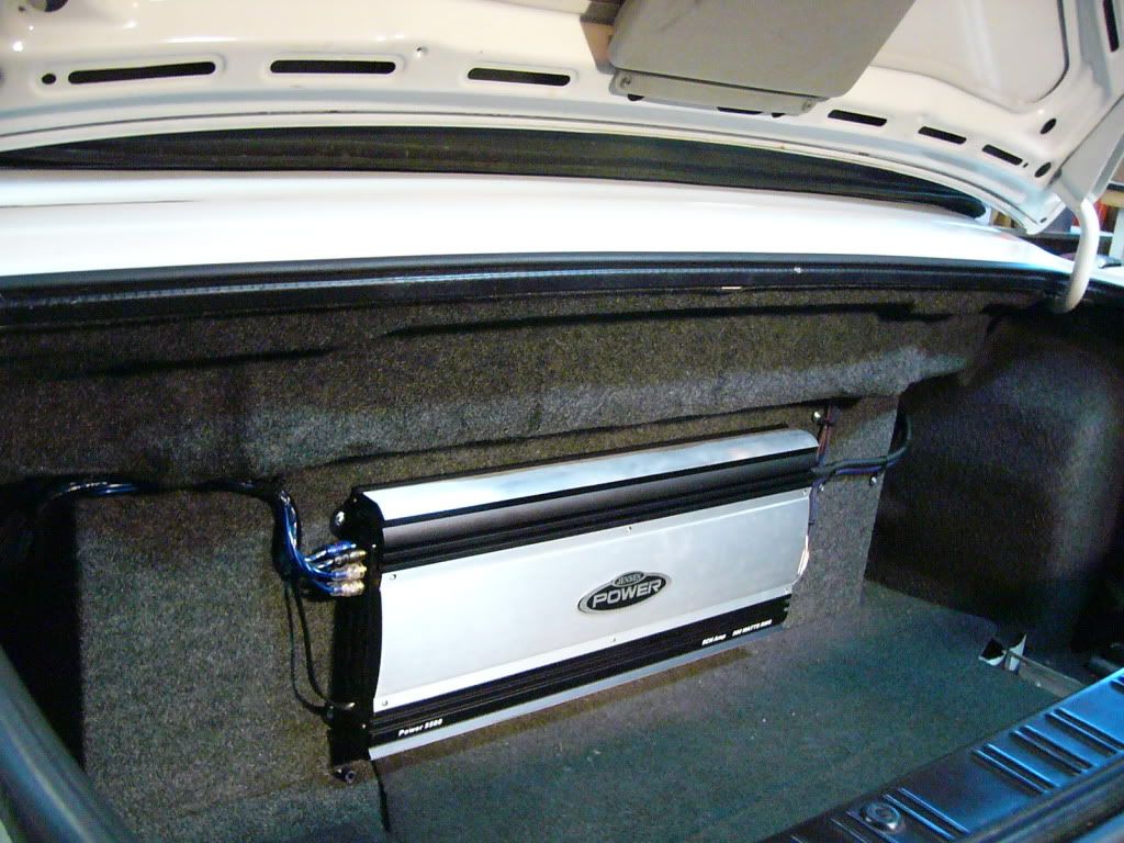

      Hey guys, here is a quick update.
      Building the amp rack on this car has been one of the most frustrating things I have done yet. Keep in mind, this is not just me building an install for one trunk and getting it done, but this has to be repeatable and pretty much a flawless fit, and be able to be installed by anyone, easily. What that means is a bunch of measurements, and keep trying until it is perfect.
      Well, here is the prototype of the 5th version of the E30 Convertible Amp Rack:
      This will fit most 5 channel amps and lots of other combinations as well. You will have a space that is 10" X 34" X 3", that should fit just about anything, as long as the wires are "end mounted" and not on the long face.
      Keep in mind, this will have a plexiglass window, be upholstered in a nice "near perfect" grey carpet, 2 fans to cool the amps and an LED strip to light the trunk. You will want to convert your stock light to LED, or just do away with it altogether.
      We are hoping to start shipping the 'vert boxes and racks this week. If you are interested, please let me know, I only plan on building 5 of these and 3 are pre-sold.
      Luke
