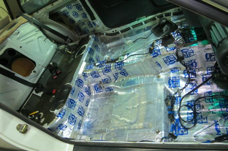

    Originally posted by DER E30
    Thanks, it seems quite a bit quieter in the road noise department!
    The subwoofer box is built to isolate your cabin and eliminate any chance of metal vibrations/rattle/racket, so any you add is basically just wasted effort/cost.
    If I were you I would focus on tire noise. Do the inside of your wheel wells first. The box will reduce general road noise and especially muffler noise significantly, far more effectively than all of the deadner you have done so far by triple. My advice is always the same: install your system and then, if you feel the need for further sound reduction (you won't, no one ever does) tackle the project with a stethoscope and test tones.
    Drowning your car in dynamat won't do any more than a few square inches strategically placed, no matter what the internet says. Hundreds of dollars, hours of effort and 50 pounds of deadner won't do what the box does, it is damn near magic.
    BTW, your work looks stellar! Keep it going and don't hesitate to call or email if I can help...but get that box shoved in place and screw it down, you will see immediately what I am talking about. Its a HUGE difference in noise levels.
    Luke

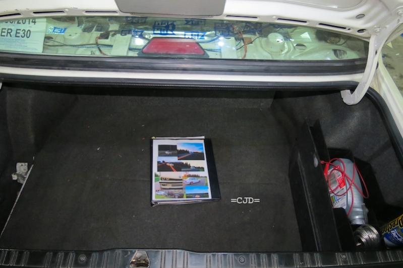

    Thanks, it seems quite a bit quieter in the road noise department! My muffler doesn't seem much improved... I pulled the parcel shelf and added a bit to the middle, but I may revisit there later, its a 5 min job to get there...
    I don't have many rattles with the sub thumping, except for my euro plate filler, but that just needs some double sided tape... Overall it is very nice sounding! Sounds very clear and smooth if you don't have the bass gain cranked... It can make more than enough bass for my taste. I need to back mine off a bit...
    I love that the space in the boot is preserved! See pic. I'll update my build thread on Monday probably.

  • Skunkworks
    replied
    Under the rear seat, on the rear deck, and wheel wells, if it were mine I would do the bulkhead too, along withe the trunk. But that's me, you are well on your way to a fantastic system...

    Luke, Should I install sound deadener on the backside of the seat? Between the box and seat metal. Not in the center where the sub is but on the sides, where it is still white.. I'm trying to decide if its worth it...
    Any ideas on places I missed other than the doors? I doubled it up on the trans tunnel.
