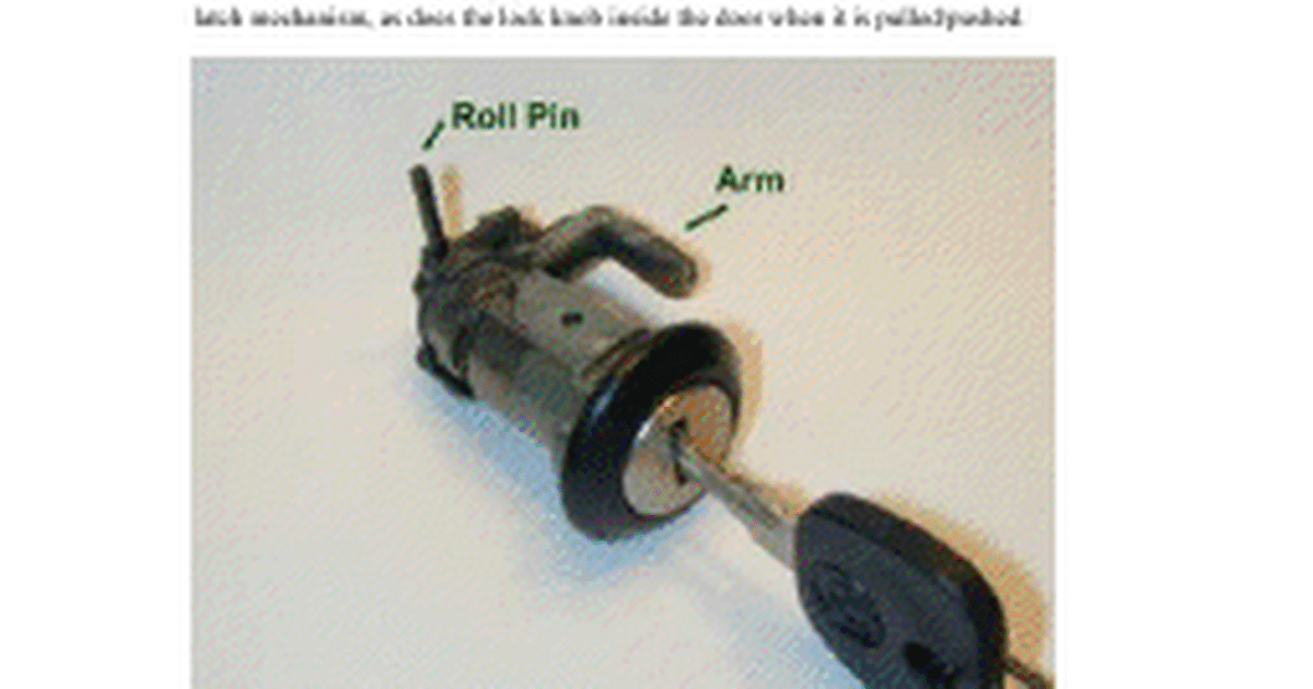

                    From your description, the electrical portion of the locking system IS working properly. However, the problem you describe is with the driver door mechanical lock. It is a common wear point (as this lock mechanism gets used the most) and the reason I recommend rebuilding that cylinder.
                    Here is a good reference for this procedure (easy).
                    BMW e30 Driver's Lock Cylinder repair When you turn the key in the driver's door, or push/pull the locking knob from inside the car, the latch mechanism is mechanically locked or unlocked. In addition, the electric lock motor will be mechanically pushed or pulled into action at which point it s...

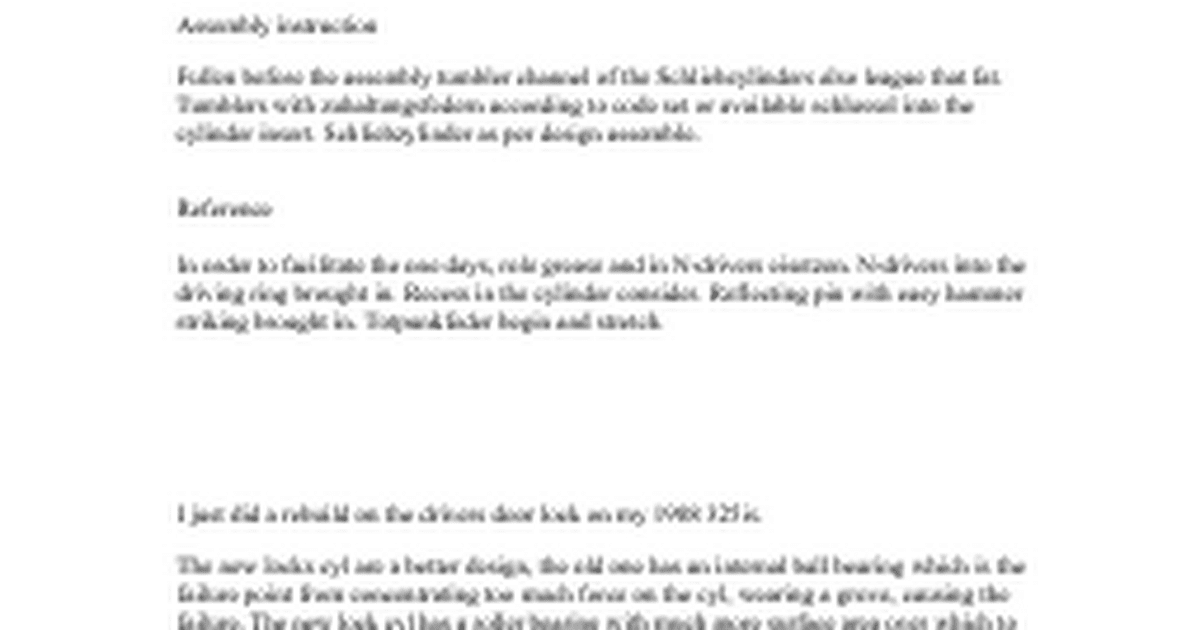

                    Assembly instruction Fullen before the assembly tumbler channel of the Schliebzylinders also league that fat. Tumblers with zuhaltungsfedern according to code set or available schlussel into the cylinder insert. Schliebzylinder as per design assemble. Reference In order to facilitate the one ...

                      Great resource, thanks! I'll dig into my locks this weekend and check for wear, then probably order both the rebuild kit and the key less system.

                          i did the cylinder swap and it works flawlessly now...i had the same problem where I could only unlock from the driver side door, now the whole system is 100%
