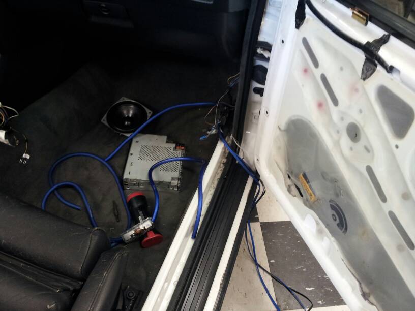

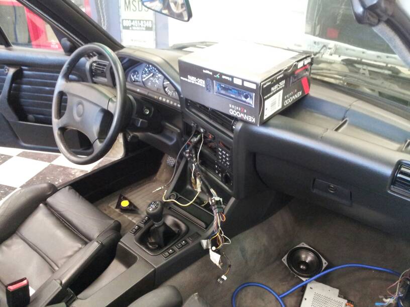

My Vert Custom Audio Install
    Headunit:Kenwood KDC-x896
    Front Components: 6.5" JL Audio C3-650 Convertable Components
    Rear Speakers: 5.25 Focal Coaxal Speakers
    Amp: JL Audio HD900/5
    Subwoofer: JL Audio 12W6v2-D4
    It is being custom built,installed and re-wired at Car Toys in Houston by a guy named Alex.

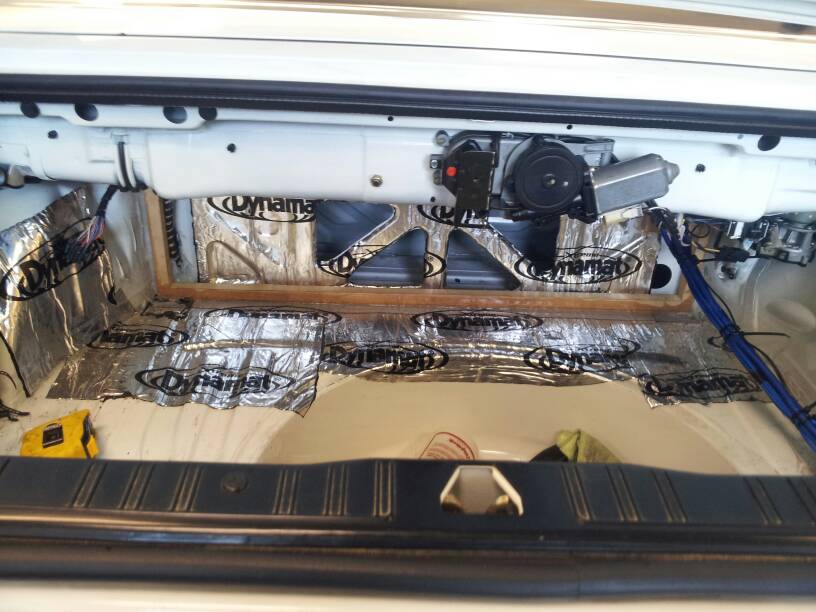

      How is the boom gonna get into the cabin?

        See the cut out ported holes? I sent him Lukes thread and he is going to copy the pvc tube idea

            Heres a few more pictures. Installed the JL Audio Bass Control Knob, Cut out port holes behind the rear seats, and installed the box. Should hopefully be completed Friday evening.
              Ahhh...didn't see the port holes in the first pics.
              That 12 should hit pretty good if your builder did his math...

                Yea he didn't do it until last night. 1st set of pictures were from earlier this week. Can't wait to get this thing back. I will have the coilovers here today at the shop hopefully. Have them installed Saturday afternoon and Rims here middle of next month.
                  Is trunk carpet going back in? I JUST installed the vert Lukebox and man was that an involved install! I wish I knew someone in my area reputable to do these kind of installs delicately in an old BMW.

                    Yes I am pretty sure trunk carpet will be back in the car. I think that was a test fit.
                      My Lukebox fit with the carpet...
                      ...and make sure you seal the crap out of the cavity. There are a TON of potential leaks. I probably spent two hours in there. Have your Bandaids ready!

                          Confused.. Which cavity? The one where the spare tire is? :/ I will inquire about the original carpet.
                            No, the cavity between the trunk and seat back. It has to be air tight for the 5th order concept to work efficiently.

                              Well, I hope it works out for you, but it really looks to me like he never touched a calculator at all. The W6 is a horrible choice for bandpass applications, thats for sure. If I were you, I would make certain that the woofer is easily accessible for servicing.
                              BTW, make sure the inside of that cavity gets dynamatted too.
