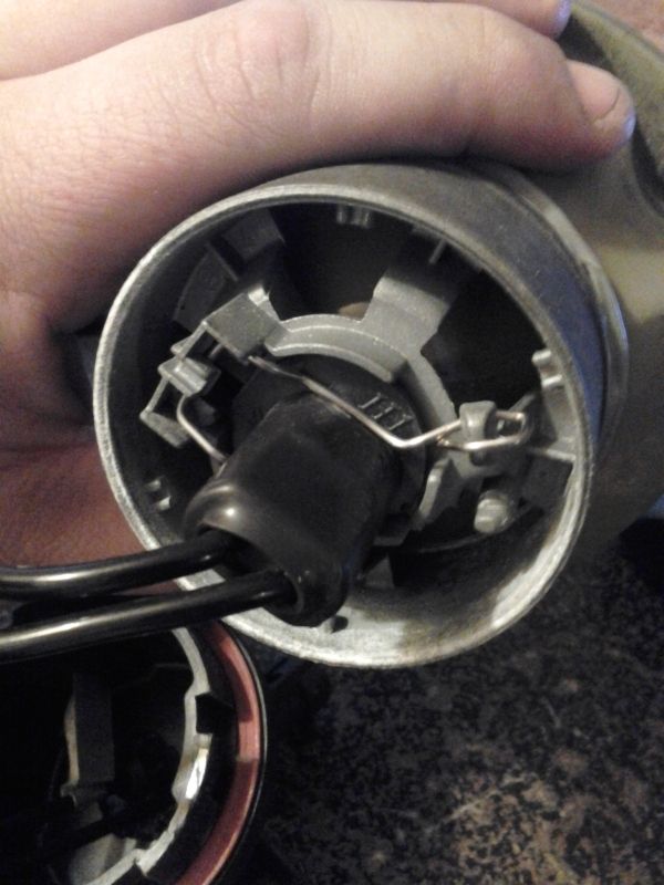

    So I was trying to adjust the new used smileys I got from Ireland from RHD to LHD cutoff pattern and the right side was a breeze. The left side, I don't even know if there is a phillips head screwdriver short enough to get between the ABS pump and the headlights. Anyway, 2/3 screws on the left side, no problem. The last screw is completely unreachable because of the freakin' Pump. Whilst fighting with it, the end cap of the lowbeam became loose and for whatever reason, the retainer clip that holds the H1 bulb in place popped out and is now somewhere below the ABS pump. All search and rescue attempt have been fruitless as the magnetic grabber won't fit under the pump and there is no sign of it anywhere on the tray immediately to the front, the left, or under of the pump. Without this clip, the H1 bulb is loose in the cap and won't make good contact with its ground. I don't know what to do. Paperclips, maybe, but it's being a real **female K9** to shape it in such away that it does its job correctly. So, wat do? It's going to get extremely hot, so tape of any sort is out of the question. No junkyards around here would have it, let alone have E30s at all. The dealer doesn't sell it. It has to be replaceable so glue won't work either. Wat do?

      Also, it took very much patience, but a paperclip was shaped into a clip that makes the lights usable. My question does remain, though. If someone loses a clip like that (and they are indeed easily losable) what do they do. Clearly a paperclip is not a longterm or permanent solution but it does work. I can imagine I'm not the only one who's ever lost a clip.

            Lol, I had the same thing happen to me.....sorta. I bought a set of smileys without one of those clips.
            Here is what I did, and it worked perfectly for 5 years.
            I found an old thin antenna from a cb radio.....(spring steel), and with two sets of needle nose pliers, made an exact replica of the one from my other light.
            It needs to be spring steel to hold itself in place properly without vibrating loose.
