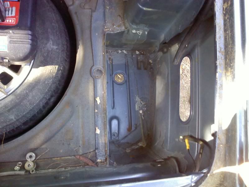

            early models have a unique floor pan which has a very narrow recess.

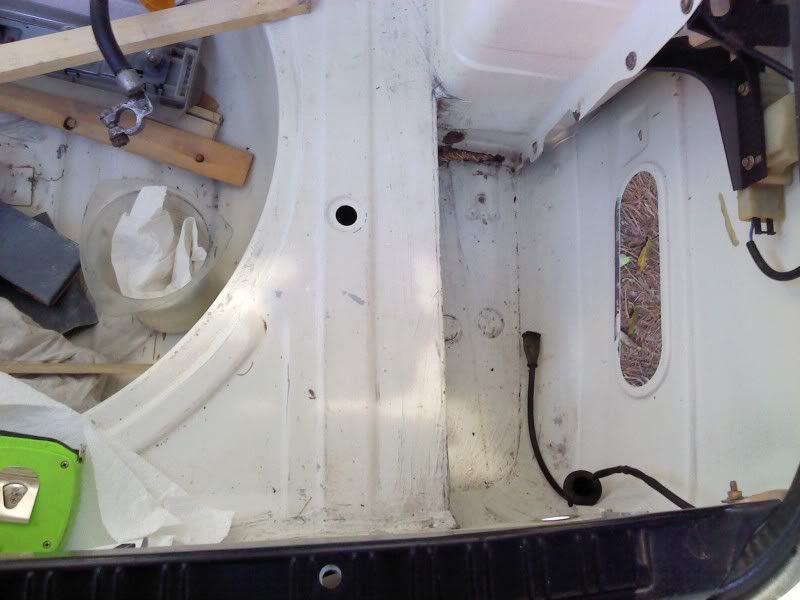

                Well thats is not exactly the early model i mean. I have an 83. 83-85 had different floor pans in the trunk as well as not having a cut out for a ski pass.
                Comparison of an 86 and an 83

                  that is small. but i was more trying to show you that you can get a good battery for under the hood that is way smaller.

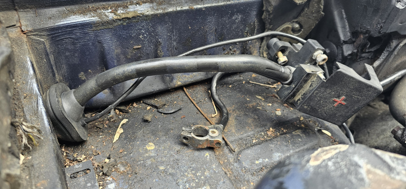

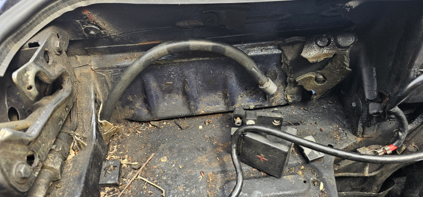

                              For anyone doing this or looking it up here/google, You need to know that if you're doing this for a 84 and up, Your firewall may or may not have the holes for the bulkhead connector shown here: Click image for larger version
ID:	10158714 If you do not have these premade bolt holes like in my 1985 318i, The best shot you have is drilling into the firewall and locking in a nut for the bolts on the bulkhead, Then you can resume business installing the wiring and the battery into the car.
                              Also to answer OP's question, 81-83 requires a small battery to fit into that pocket plus some creativity involving the connectors since that is half the size of the 84-92 pocket for the battery. Cheers
