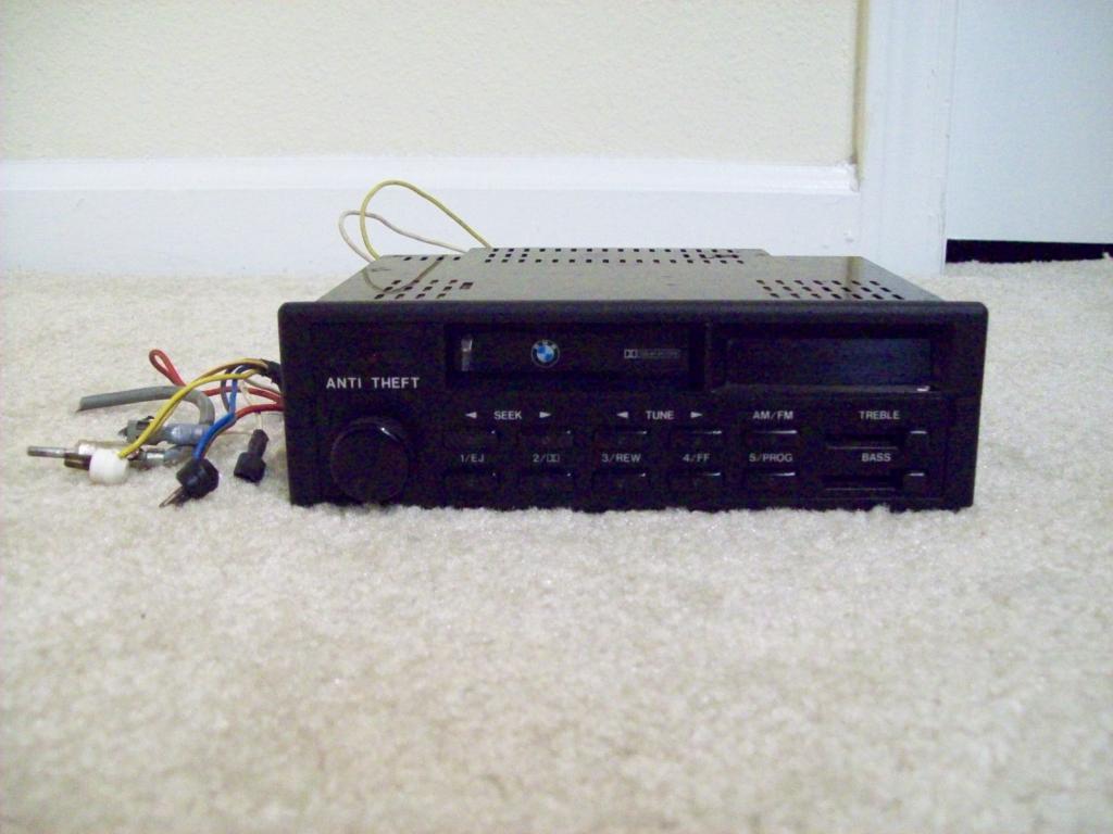

    So my attempt at getting the stock radio back into my e30 has become quite a puzzle. My car had an aftermarket radio when I bought it, and the stock harness was cut through. My car has the fader wheel above the radio area, and has tweeters on the doors, but not sure if the rear speakers are 'premium' or 'standard.' I am also not sure what was original or added over its long history.
    I purchased a 'premium' radio (pictured below) and the harness for it which fits nicely. However, we were trying to get it wired into my car and discovered that my car has fewer wires coming out of it than the harness has. In addition, I looked at the wiring of an e30 m3 owned by member Archie. He has the 'premium' radio, but his harness coming out of his car has more wires than my car. And we were successful in plugging in the radio I have to his car.
    SO now I'm back to figuring out which radio is truly meant to be in this car. I have attached pictures of two examples below. Please advise, is it one of the ones pictured below or a different one completely?
    The car is a 1989 325i. I also looked up the VIN on a VIN decoder and it did not mention anything about premium sound, despite the tweeters and other premium items being there.
    Premium (Currently have):
    Other kind:
    My harness in the car vs. Archie's e30 m3's harness:

        Your car has the fader, so it will have less wires than Archie's car, which does not have the fader. Your wires are there, but they are part of the harness after the fader switch.
        Therears are not premium, but the tweeters are part of the premium kit. Either your car has premium sound and someone changed the rear deck and speakers, or they added the tweeters.
        Pull the trunk liner on the left side and check for the premium amp in the trunk, it will tell you for sure.

                    I just checked and no amp, just the antenna motor.
                    So no premium sound, fewer wires in the harness, has the fader in the dash, and curiously has the door tweeters.
                    Does anyone know what the radio headunit options were in 1989?

                      Ross, thinkin it's this guy.

                              The Premium Sound system came with the Pyramid Radio (with the infrared finger-slider slot) and this radio has the fader control built in.
                              The regular sound system came with the CM5905 radio (with the separate bass & treble slider controls in the lower right corner). This radio doesn't have a built-in fader so it uses the fader thumbwheel insert that's already in your dash and works on cars with the premium sound system.
