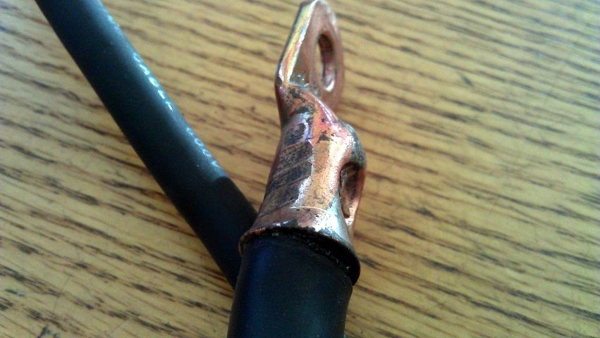

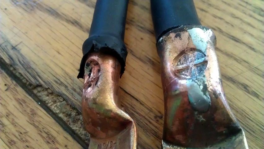

          Another noob thing I did was just heat up the lug with mapp gas and
          filled it up with molten solder. Then just dipped the wire in.
          Seemed legit but I guess it's not how you do it.

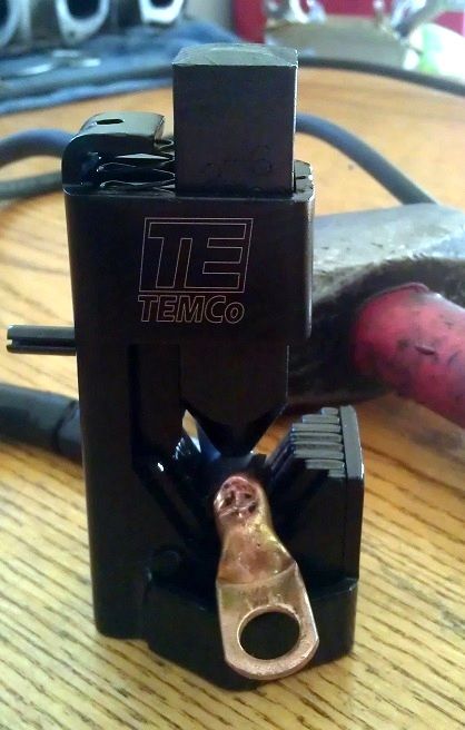

          Bought this sweet crimping tool for $20!
          Again, just another noob wiring thing.
          Picture from their site:
