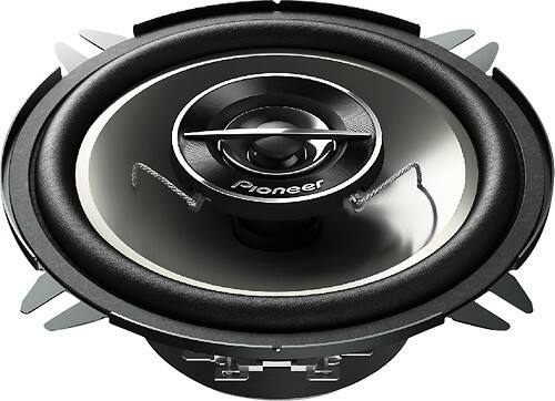

    Look, here is the reality: you have 12 watts per channel of actual RMS power (don't believe the 50WX4 BS printed on the deck, it really is about 12w X4) and shitty speakers that will not make bass in the location they are mounted in. No amount of bullshit is going to fix your issue...and turning the HPF on will sound like absolute shit.
    Go ahead and try it, its only a few seconds to change.
    Oh, BTW, most likely that "popping" sound is the speaker hitting the grille. Pioneers cones protrude past the edge of the frame, and BMW speakers are recessed. If you don't space the grille away from the frame, you may have "popping" noises, even at low volume.
    The simple fix is yank those shitty Pioneers (Kenwoods, Alpine, whatever) and drop in a set of Premiums. You will get about triple the bottom end and radically better power handling, all for the price of a set of junkyard speakers...if you get lucky.
    However, clearly you need better performance in the audio department. You aren't going to be happy until you do something better than a "deck and 4".
    You need some kind of subwoofer, ideally one that does not suck. You also need some decent power and speakers that will actually work in a BMW. Those Pioneers will not do unless you have a subwoofer, and then you can use that HPF as it should be used, to allow the mids and highs to play cleaner and clearer, while the subwoofer handles the bass. That does not mean you need to be some baggy pants thug, nor do you need to be "boomin tha hood, yo", as a proper subwoofer will simply play nice clean, clear bottom end without annoying your neighbors or attracting the cops...or thieves...assuming you control yourself.

          Here is the issue:
          'The pioneer is not recessed below the frame, the surround sits above it:
          The proper speaker not only has a recessed cone, but actually is recessed in the hole too. Here is a stock Premium, for example:
          So, when the Pioneer was installed, it needed to have the stock grille spaced away from the speaker about 8mm or so.
          None of this other bullshit, like removing the last trace of bass from his audio is anywhere near correct, especially if the goal is to "work with what he has".
          His bottom end response is radically limited by the grille being smashed against the cone and your suggestion is to remove more bass?
          Lame.
          Sorry, that is typical "installer think" where the goal is to get whatever hackery out the shop as quickly as possible. I lived that shit for 30+ years, I did not condone such cheap tactics then and I don't now, either. My goal is to actually make his system perform better, not just apply a bandaid.
          So, the easy fix is this: take the grilles off, pull the speaker screws one at a time and put a nut under the head of each screw, making them into a "post" of sorts. Do this for all three mounting screws, then use a tiny dab of crazy glue to glue the same nut on the inside of the grille for the 4th screw. Make sure that screw can still turn, because stabbing it into the hole through the grill is a challenge.
          Its kind of a pain in the ass to do so, thats why most so called "pro" installers can't seem to do it right, but that little space will make all the difference in what you are dealing with.
          Move those grilles out 8mm and your issue will be gone.
          Good luck!

              Here is the issue:
              Lame.
              Good luck!
              Luke
