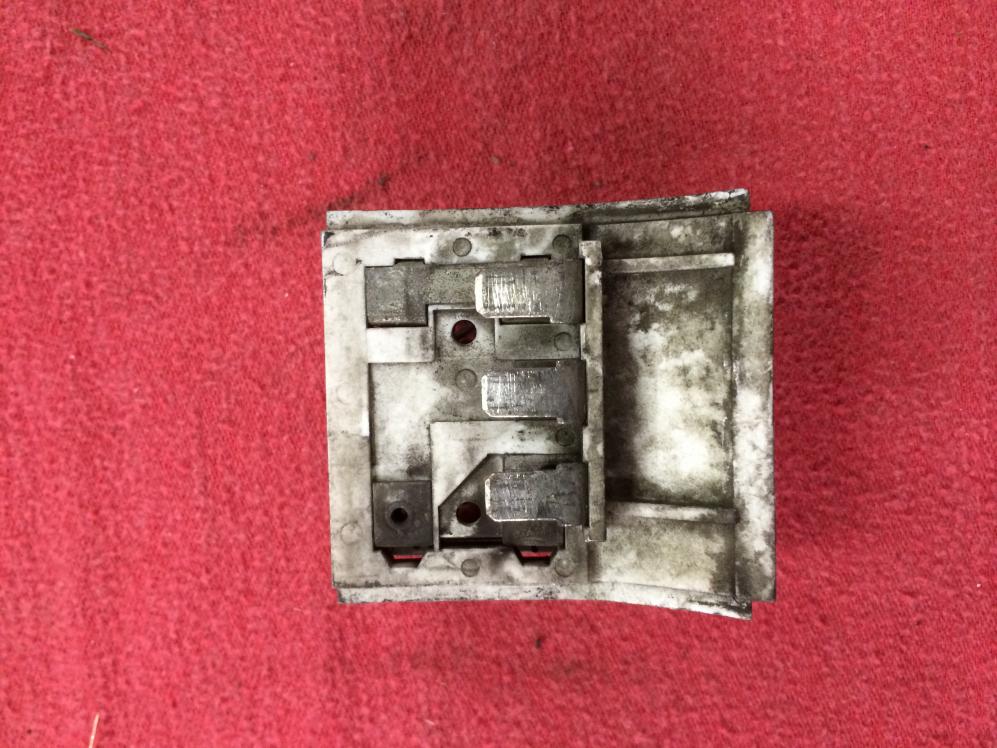

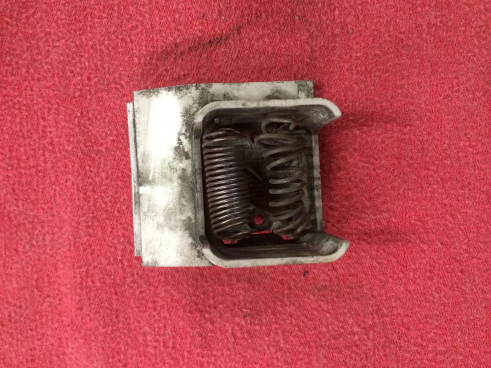

    Hi, my E30s blower motor will only work on the highest speed and from what I read on the forums the problems seems to be with the resistor. I took out the resistor and the coils on it were bent so I thought it would be best to buy a new one, but when I looked online for one all the resistors had three coiled wires when mine only has two. Could I have been on the wrong websites for the resistor? I also read that the early E30s had a three speed fan but I have a four speed switch (I have a 1985 325e). Could someone have changed the switch or is my car suppose to have a two coil resistor? If anyone has any ideas id love to hear them.

          Post a few pics.
          88 M3 - LACHSSILBER
          89 M3 - ALPINEWEISS II
          • Jackhdmn
            • Mar 2014
            • 61
            Here it is.
