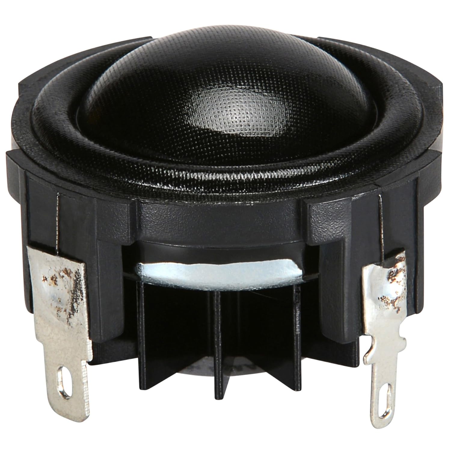

                  Originally posted by nrubenstein
                  Why not find a tweeter that you can source easily as well?
                  I thought we did! These are $30 or so a pair, are far higher quality than Polk, JL, Focal, or whatever typical aftermarket units units, fit our cars perfectly, are extremely well documented, are a true silk soft dome and kick the shit out of most anything that isn't megabucks stuff.
                  I am also very excited that this tweeter has an actual heat sink, so for extended high volume listening, it should remain more stable. From what I have seen, this is an awesome tweeter. I won't recommend it until we have had some serious listening time and get to do some measurements, but so far, it looks a winner.
                  Oh yeah, it can also be had in a titanium dome, for those who like a much brighter sound:
                  Dayton Audio ND25TA-4 1" Titanium Dome Neodymium Tweeter with GrillThe Dayton Audio ND25TA-4 is a versatile 1" titanium-dome tweeter that offers the performance of more expensive tweeters in a compact and stylish package. It features a Dayton Audio exclusive round faceplate design with integral perforated steel grille, and a small yet powerful neodymium motor with attached aluminum heatsink and ferrofluid-filled magnetic gap for reduced power compression and improved long-term power handling. The carefully-designed titanium diaphragm provides clean, crisp treble response to beyond 22 kHz, and delivers superb sonic detail and dynamics with low distortion. A copper pole cap further reduces distortion and inductance effects.Choose the ND25TA-4 when you need maximum dynamic impact and powerfully-rendered sonic detail to keep up with a high-output midrange or woofer. The compact round faceplate design integrates easily into your baffle design without claiming a large amount of real estate, and the integrated grill protects the titanium dome from damage.
                  Parts Express is an excellent vendor, quick shipping, great customer service, all that. Between price, availability, (hopefully) performance and quality, this is a winner in my book.
                  We will also be experimenting and hopefully others will too, so we can all learn from one another and make better sound everyone can afford.
