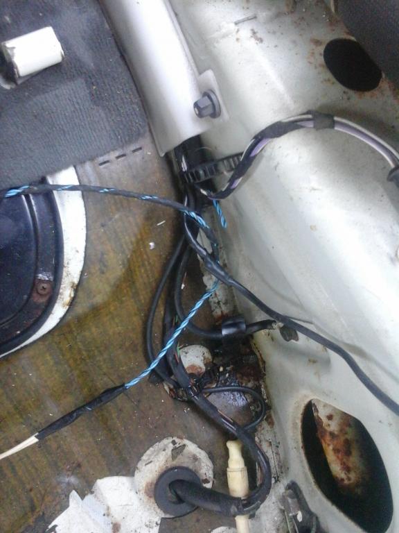

    Hey so when I bought my 1990 325i vert it had a god awful aftermarket radio in it and it was badly installed. It seems the stock amp was also bypassed.
    Now I want to put everything back to stock and I got pretty confused with the wiring. Problem is the code message shows even if I have the right code, I tried this with 2 different radios.
    So first picture how its wired now

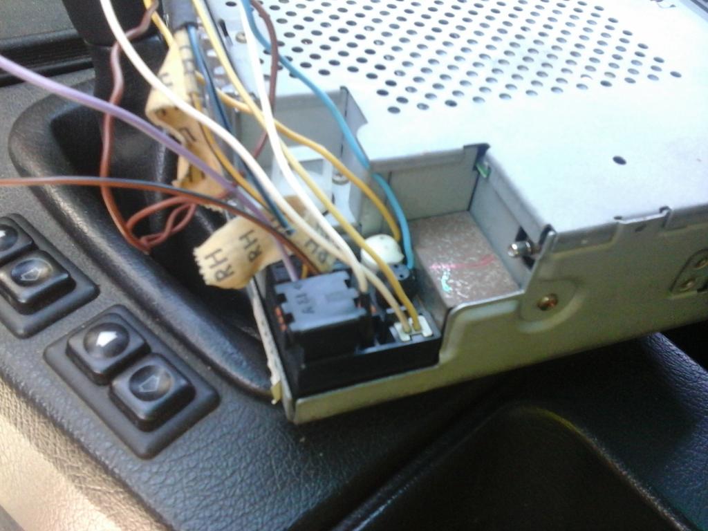

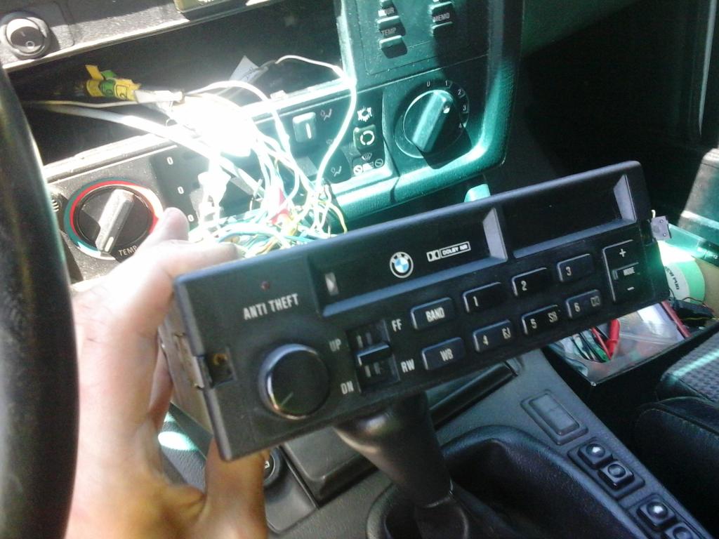

    Second picture is my HU
Name:	2014-06-01 14.18.43.jpg

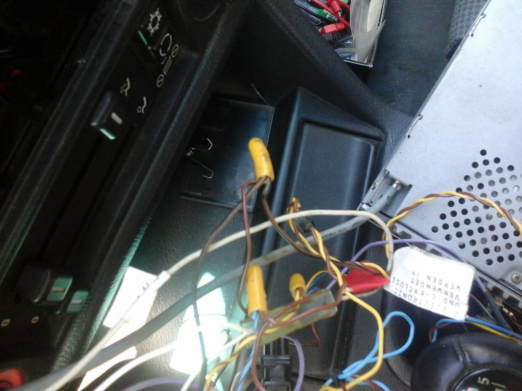

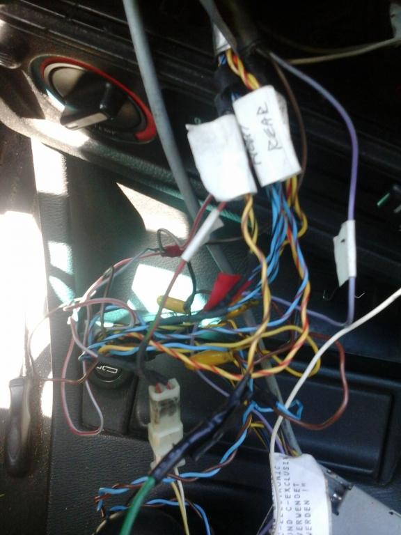

    Then I got a brown wire that is connected to YL/BR
Name:	2014-06-01 14.19.54.jpg

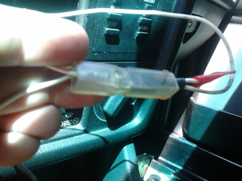

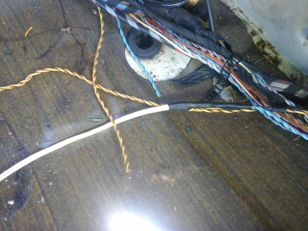

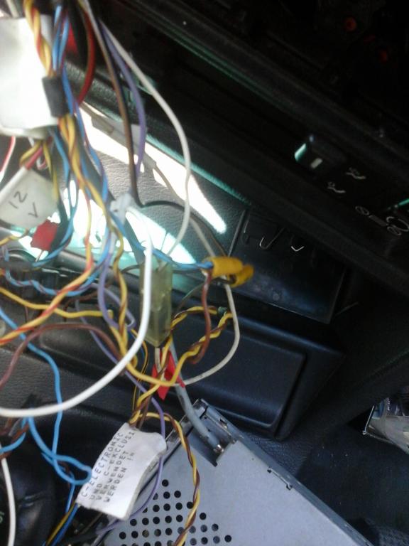

    Then one connection missing from the white antenna/power wire
Name:	2014-06-01 14.20.44.jpg
    Then three BR/BK wires connected together? What does that do and where are they supposed to be?
Name:	2014-06-01 14.21.48.jpg

    And here BU/BR connected to Brown
Name:	2014-06-01 14.22.13.jpg

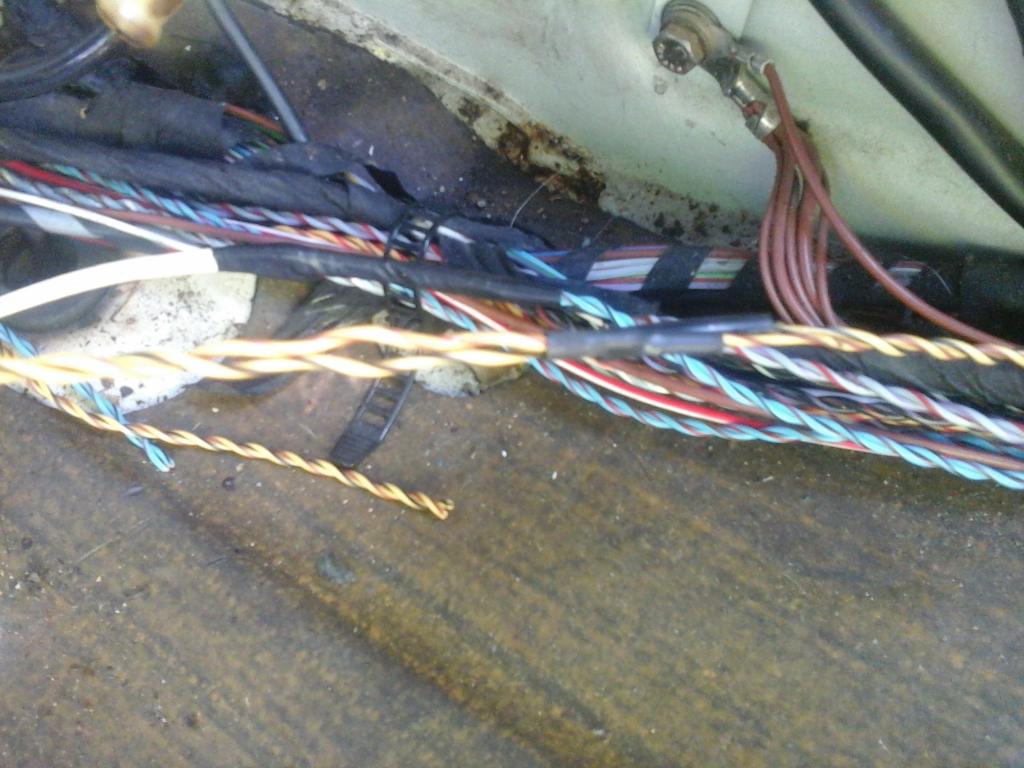

    Here we have two YL/BK and YL/BR that have been disconnected. So one of these is supposed to go from the HU to the Amp and then back to the speaker right, then I am missing the connection to the speaker.
Name:	2014-06-01 14.23.50.jpg

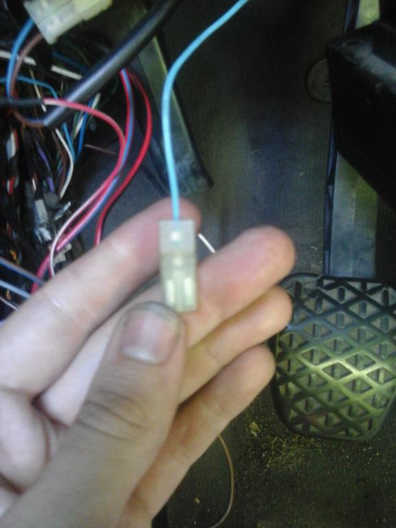

    This ones is a freebee, I was wondering what it does, its from under the dash
Name:	2014-06-01 14.25.08.jpg

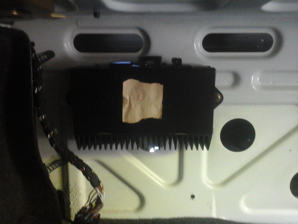

      Here is my stock amp that I can just reconnect.
Name:	2014-06-01 14.26.45.jpg
      So I was wondering if the radio check if its connected to speakers before it verifies the code and maybe that's why it doesn't work.
      Any help and info to lift the fog of confusion would be appreciated.

        OK, so this has been covered about 5 times in the last few months, but lets do it again:
        The amp requires 4 positive leads. Yellow are left, blue are right, brown stripes are ground, as are the brown/black wires.
        So, at the deck you will have yellow/red (left front) and yellow/black (left rear) blue/red (right front) and blue/black (right rear). Each of these wires should have a ground twisted with it, all 4 just connect to radio ground.
        LMK if that doesn't get it for you.
        gl!
        Luke

              And does the amp require a white power wire from the radio to turn it on? that's what the wiring diagram says but I can't find it

                  If you read the "bypass" thread it might make more sense.
                  To the amp you will have yellow and blue, but from the amp to the speakers it is black (rears) and Gray (fronts) and both will be twisted pairs.
                  See the bypass thread for polarity

                    So everything is finally wired up. Thanks for the help luke.
                    Just for your information the YL/BK and BL/BK where my rear speaker wires and the black wires from the amp went all the way back to under the dash to a connection where they changed colours back to YL/BK and BL/BK.
