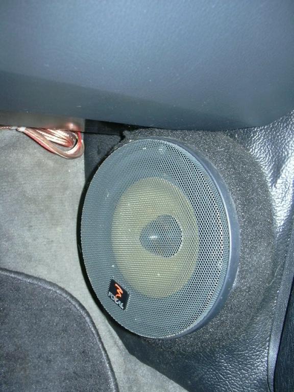

    I just put in new speakers up front. With the right amount of bass the speaker touches the kicker panel and makes a disgusting rattling noise.
    Besides putting the premium bmw speakers in and returning the new ones, what are my options? I've tried putting a little more foam on the back side of the panel but its not enough. I plan on putting more in to see.

        Here is the trick: grab 4 small nuts. Pull the screws that hold the speaker in and put the nut between the head and the speaker, like a washer.
        Then, when you put the grille back on there won't be any clearance issues.
        You can space the panel about 1/4", should be enough.
        For the 4th screw, I use crazy glue to hold the nut to the kickpanel. Its kind of a pain in the butt to get that back in properly, but not that bad.
        GL!

          I built custom kick panels.
          Luke's way is easier.
