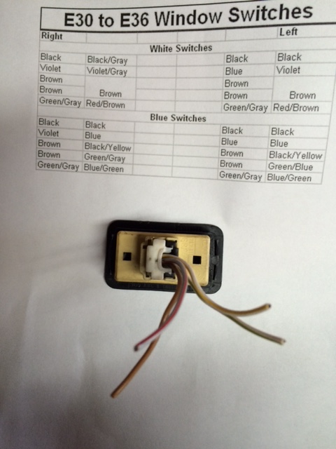

    What E36 window switches do I have?
    I want to install some E36 switches in my E30. I bought a set of E36 switches, but they don't look like either the white or the blue switches. And the wiring doesn't match up. Can anyone offer any help? Thanks!
    Kurt V
    1991 318is
  • ManSalad
    • Jan 2014
    • 418
    It looks like you purchased a one-touch e36 window switch. You can tell if its one-touch by the small base or if you feel two clicks when you push down on either the up or down arrows.
    If you wanted a simple install without the luxury of the one touch open/close function, you wanna get the big white/big blue base e36 switches which looks like this.
    Then you would wire them up accordingly. I suggest using twist caps to temporarily (or permanently) wire them together just to make sure they work and it makes it easy to undo and switch wires and what not. I just kept them with the twist caps which works fine but doesn't look pretty lol.
