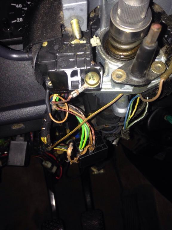

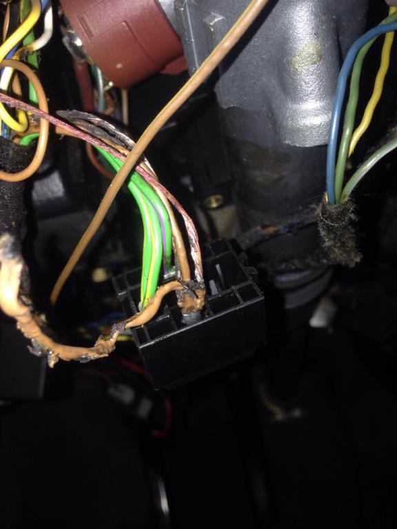

So I pulled and reinstalled my gauge cluster last weekend. After doing so I noticed a clicking feeling in the steering wheel when turning. While investigating it tonight I noticed the headlights would dim if I turned the wheel right. It would only dim at certain spots. Stupidly, I held it at one of the spots and smoke started pouring out of the steering column. The brown wires in the column seemed to have been fried. Anyone know why this would happen? Everything in the gauge cluster worked fine.

Originally posted by Gregs///M View PostThe fuse box has incorrect sized fuses.
I checked the fuses and they're all good. Basically the turn signal eliminator switch is shorting out on something when it's triggered while turning the wheel right. I don't see any tangled wires or anything else out of the ordinary in the column.

I think the clicking I'm feeling was the electricity jolting through the column. I still can't figure out why it's shorting out. If you're not burning up wires, clicking would indicate your clock spring is on its way out.
Originally posted by Skychismo View PostI checked the fuses and they're all good. Basically the turn signal eliminator switch is shorting out on something when it's triggered while turning the wheel right. I don't see any tangled wires or anything else out of the ordinary in the column.
If the electrical fuse panel was like OEM, the fuse would have blown and not fried the wires. In your case, someone put a larger amperage rating fuse for that circuit and now the wiring itself is the fuse, not the actual fuse.Owner - Bavarian Restoration

Originally posted by Gregs///M View PostIm not saying to check if the fuses are good, im saying the wrong size fuses are installed.
Sorry, by "good" I meant the correct fuses are installed. I'm not sure why they didn't blow.
