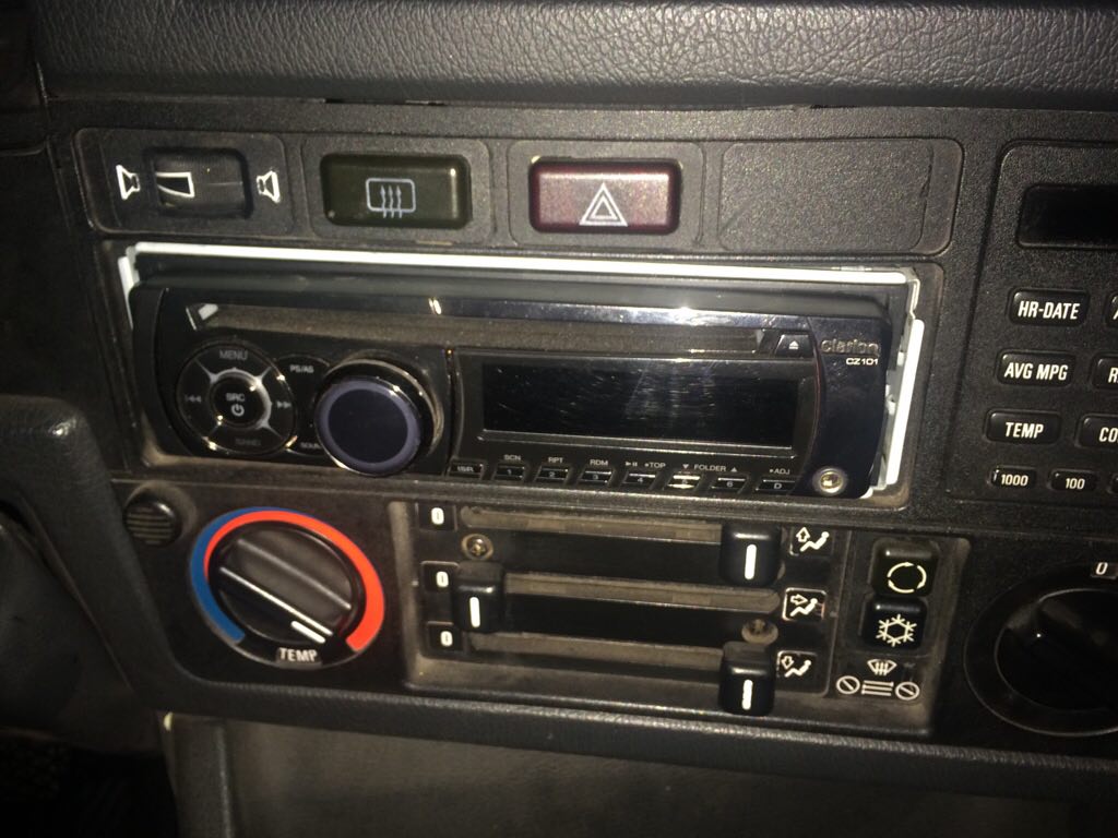

            Yeah this worked. I used two knives. Thanks guys

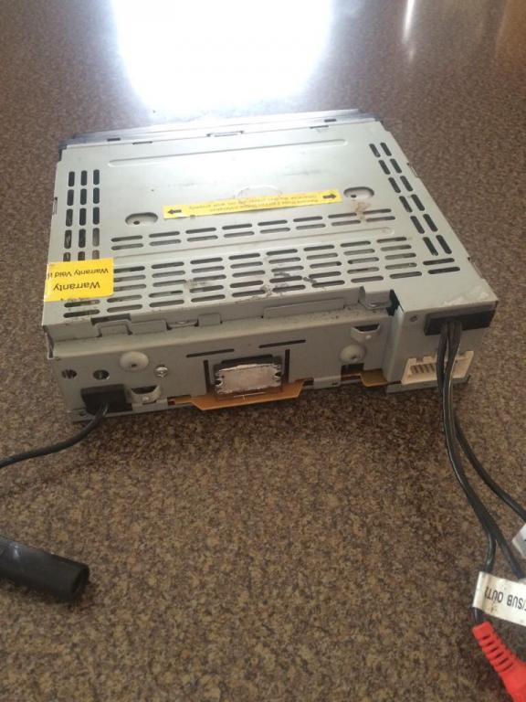

                Ok so i got the radio out... but now i have no idea where the fuse is or where to access it. anyone have any ideas?

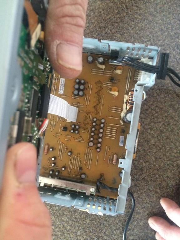

                  Usually it's on the back. Is there any screws in the casing that you can take out and split it to see the mother board

                    Who pulled the heat sink off the back of the deck?

                      Me. Trying to get inside of it but cant figure it out. I took all of the extorior screws out but still cant see the mobo

                        Most radios have no internal fuses, if thats what you are looking for
                          Yes i got it out but still dont see a fuse ...Click image for larger version

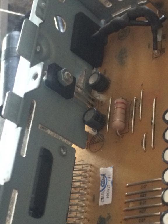

                            What the hell there is always a fuse.

                              Could this be it? Click image for larger version
