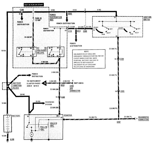

I'm just now getting to some electrical gremlins in my car and I would like to get some input.
Symptoms:
1. Blower Fan continues to work on settings 1,2,3,4 after key has been removed from ignition.
2. Recently with cold temperatures when I start the car and want to defrost the windshield while warming up at idle, the blower fan will come on and off.
Example: I will come out to the car to warm it up and switch the fan on to setting 4 to defrost the windshield, and the damn motor wont come on. A solution I have found is revving the motor to as high of a rpm needed for the fan motor to pop back on.
3. When driving before the engine is up to temperature, it seems, the window switch lights flicker also meaning power to the window motors will flicker on and off.
Diagnosing:
1a. I have a clue from a diagram I am looking at,
I'm thinking the K4 relay is the problem because that could be the reason the blower fan will go on and off. As well as when the key is out the relay could be letting power through since it is hot at all times. As to the windows power coming on and off, I have no idea what correlation that would have with the K4 relay, or what pertains to be the problem. If I'm not wrong the K4 relay is in the fuse box as well.
I have very little knowledge on reading diagrams, and even less knowledge on wiring and electrical, so this is all something I came up with in my head. I don't know how to test a relay, that may be something else you guys could point me in the right direction with as well. BUT I may be over thinking this and there is a simple solution so hit me with it if you got it!
Thanks, Zack.
