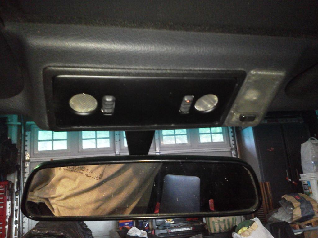

Hahaha only if you promise not to hate me for it, I'm no professional, but it works for me.
So I DIY'd in a map light, but that wasn't enough for the black void that is an all black interior...
I followed this DIY on the mirror map light: http://zoso.no-ip.org/318i-maplight.html
TL; DR: You grab the constant 12 volt and ground from the rear passenger light and then run wires in the headliner to the front for the map light / dome light.
Then I just tested the dome light assembly with a 9 volt battery to figure out what combinations made the outside ones work.
Then spliced it into the wiring for the map light. Viola working lights.
After that I also had to do a some filing to get it to fit into the old check panel square.
Its also worth mentioning that I brought the door switched ground forward while I was doing this incase I needed it later.

So the e46 seems to use switched positive rather than switched ground. In theory you should be able to just switch the ground and positives, but by no means am I an electrician so don't take my word for it. I blew like 6 fuses trying to get it all working. The real problem is there is only one ground for all of the switches.
For someone that wants to help finish it and get the ambient and center door light working:
I was thinking that you should be able to solder some wires to the "board" (the "wires" for the lights look like the lines on a computer board for electricity so thats what im calling them) cut and then change it to the e30 compatible setup.
Also if anyone is interested I can grab those dome lights the next time I go junkyard hunting. Cost plus a small finders fee? ;DLast edited by pb34; 02-25-2015, 09:00 AM.sigpicComment
I'm putting mine in a vert so the dome light, so to speak, is right next to the check panel light, so I will use the wiring from the original light set up. What did you do about your check panel dash light flashing and not being able to cancel it on the check panel? I think it would drive me crazy if I had to just deal with the constant flashing light in the event that there was an indication that should show on the check panel. One other question that I have is do the map lights point correctly since the angle on the e46 is different than the angle of the check panel?sigpic

That sounds like a better plan to get the constant 12v and ground.
So that might be a difference between the 325 and the 318.
The seat belt light was in the overhead check panel. So since it is entirely removed its gone. No flashing lights.
Haha, yeahhh That is one slight issue. I specifically put the dome light in that orientation because it minimized the light that hit your face. It is pretty much aimed at my chest so it isn't too much of an issue and the extra light is definitely worth it.
If you were to flip it around its almost pointed horizontally and it really gets you in the eyes.sigpicComment
I got the ambient lights to work by running a wire from the light that illuminates the panel where your headlight switch is located. That way the ambient lights only come on at night or when you turn on your lights. You can use a nine volt battery to determine which wire is the hot for the ambient. On mine it was the red/purple wire. I will take some pics tonight.sigpic
