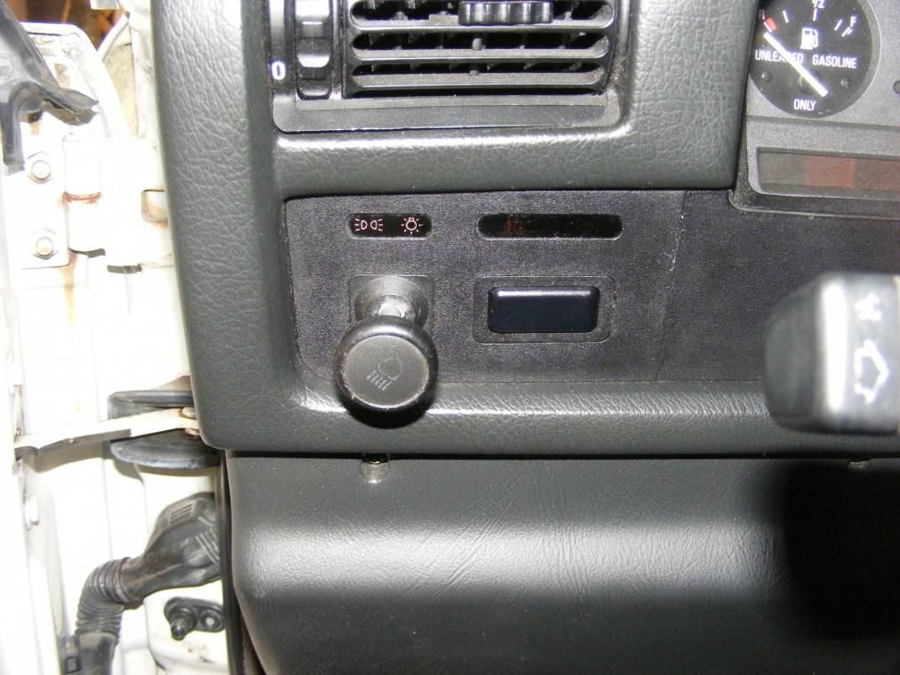

    Tried to take pic showing the ambient light working at night but I couldn't turn off my flash on my phone. I'll try it with my camera. but here are the pics of my install and where I ran the wire. It was pretty simple to run it down the A pillar to the headlight switch area. Again, I just taped into the hot wire of the bulb that illuminates the panel pictured.

        Not sure I understand your question but if you are asking where it tapped in for power, the first picture shows where you turn on your headlights. There is a bulb there that illuminates the panel when your lights are turned on. I tapped the hot line of that bulb so that any time I turn on my headlights, the ambient lights come on also. If I misunderstood your question, sorry! Also, my car is a vert so my dome light was right next to the check panel. I used the wiring for that to connect the spotlights. Have not figured out how to wire the door activated center dome light yet.

            Don't want to take apart my dash/speedo just to take a picture of the bulb and wire. When you go in there, you will find it.

                No. I was in there doing something else and took advantage of the opportunity. You can access it by removing the knee bolster and reaching under the dash though it is very awkward.
