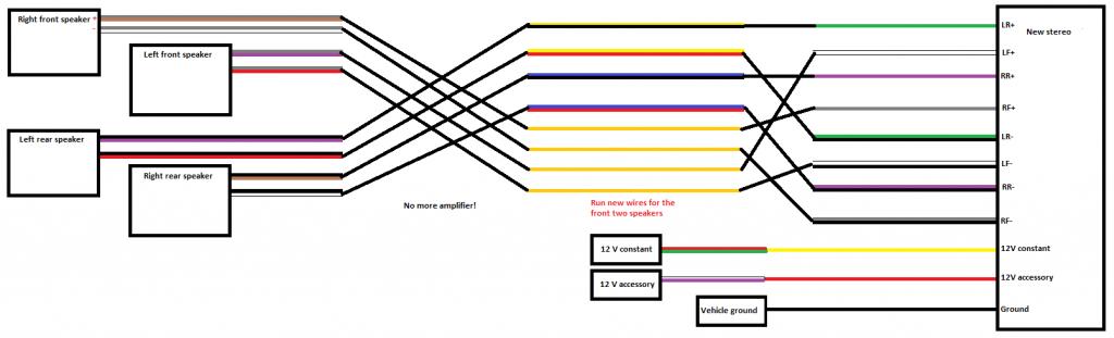

    Pulled the radio and found this. I can't even ... I suppose PO wanted an alarm? I've been pulling out punds of wiring that's not connected to anything.
    So the white wire is connected to something else (notice it going to the left). And the rest is just all over the place.
    Car is 1988 325is (im guessing non-premium sound). Front speakers dont work. The fuel pump buzzes when radio is on. I've checked G200 and it doesn't look corroded.
    I don't know where or how to start, never done this before

          Yeah, that really isn't that bad. Cut everything on the car side of the butt connectors and start fresh. Look at the amp bypass thread sticky for how to wire everything.

            If you have front tweeters, you likely have premium sound.
            I have tweeters, so I guess I have premium sound (reading the amp thread).
            Hmm, so one of the problems is, that the PO installed this, and I don't know what is which wire (color) on the aftermarket HU. So I don't know which wires to combine when I start cutting. Also, see those 3 brown wires combined into one black? Isn't that one of the basic no-nos? Combining grounds?

              All aftermarket decks use the same colors these days.
              If you do have premium sound, just do the amp bypass. But run new wire to the fronts, repurpose the rears.
              Go find 20 feet of normal 16ga speaker wire, you will need it.

                  This is the radio connector:
                  I think this applies here:
                  This is from the cars side:
                  So obviously the braided pairs go together, but these I have no idea how to pair:
                  Looks like the antenna power cord? And what's the white wire thats not coming from the loom?
                  Power?
                  Grounds & mystery lilac? =)
                  So all i have to find out now is this:
                  • There should be 6 pairs (tweeters, front, back) I see max 4.
                  • Are the tweeters spliced from the fronts?
                  • How are the grounds handled? Is the negative (-) spliced into a negative and a ground? (does this apply to tweeters too?)
                  • If yes, where are those grounds connected to the chassis?
                  I've ordered some 16 gauge wire and some butt connectors with heat-shrink.
                  Sorry for the newb questions =) Btw, after disconnecting the radio my el. mirrors suddenly began to work again. Wtf?

                    the tweeters are connected to the fronts. Have you checked the amp bypass sticky thead? I recently did my convertible's head unit and it involved connecting both the front speaker wires (from the head unit) and both the rear speaker wires together from the head unit harness.

                      First, take the damn cage out so you have some room to work. Don't mangle it, use a pick to get the tabs that are bent in.
                      Pull the harness more out of the dash, and unwrap it until you get back to the fader harness branch and the ground junctions.
                      Post a pic of the progress...oh, and quit posting pics of your aftermarket deck, they are all the same colors on every deck out there, does not matter what it is, just get the cars wiring correct and it will sound fine.

                        @cody, yes I've read it, but its kind of overwhelming for someone who's never even attempted to change the stock unit =)
                        @stereo
                        yes sir! I have tried to get it out more, it feels like its stuck or something (in the picture its pulled out as far as it will go). I'll take out the cage and try again.

                              So, after taking out the frame (that thing was jammed in there good). I failed to see any additional wires:
                              Thats why I peeled back the tape to see what's going on and saw this:
                              This is where started thinking where do all those wires disappear to? Well...
                              This is pre-fader (note all 4 pairs present)
                              There are also these things which essentially end up being the grounds for the previous blue/brown yellow/brown pairs (post fader).
                              My logic tells me the 4 pairs should end up in the 8 "ports" of the fader.
                              And then continue from there to the radio. What I don't get is why is there a brown
                              (ground) in the fader, and why's there something that looks like a power cable in the fader (lower right corner).
