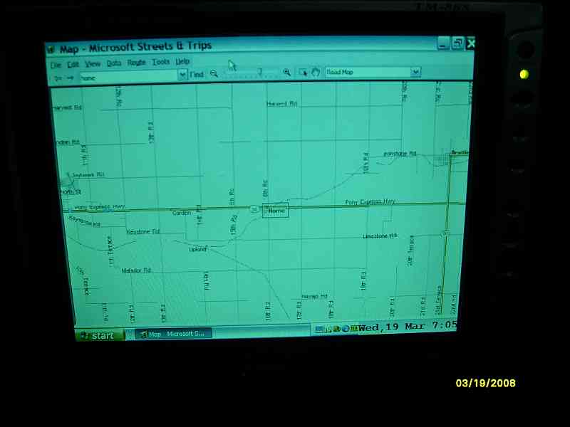

    Microsoft Streets and Trips.. Works very well when on the road.

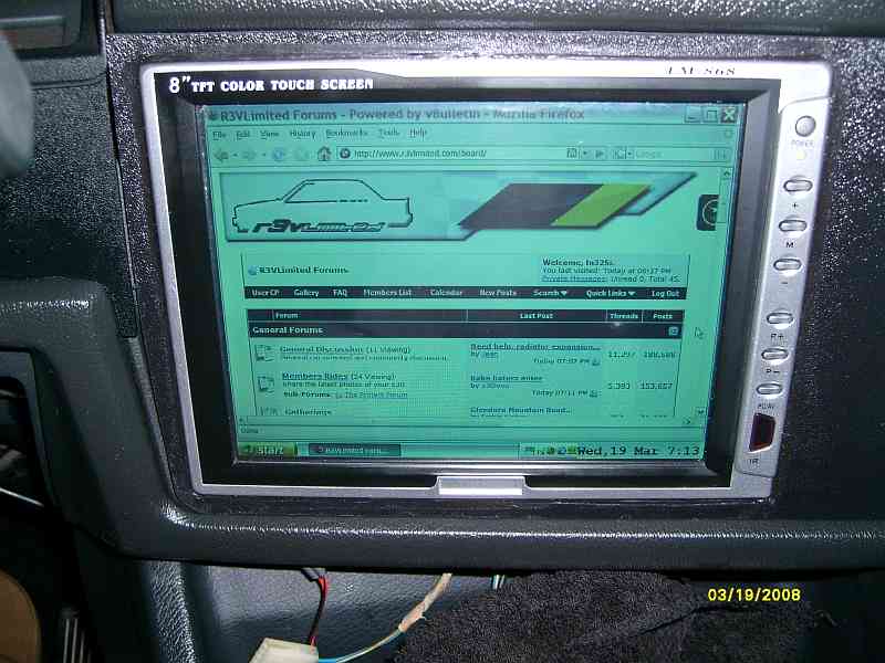

      And the greatest of all... Surfin the web !!

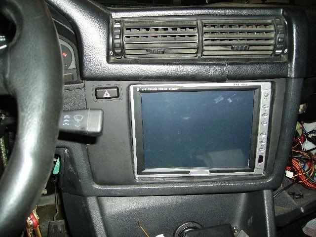

                      Originally posted by tn325i View Post
                      The progress so far. I have the panel finally made and the carputer was built back around xmas for another car. Decided to try and make the screen mount in the center of the car so it looks as oem as possible.
                      I still have some switches to mount and working on an interface that will allow me to switch most anything in the car on/off from the icons on the touchscreen. Hope to have that worked out by summer..
                      I have Megasquirt on my car and use my screen to monitor operations. I also am running wireless internet w/ email and gps navigation. Just for starters..
                      So here some pics.. And again, it's not finished but I think you can see where I'm going.
                      Looking good Steve, can't wait to see the finished product...
                        #41
                        Originally posted by NitroRustlerDriver View Post
                        Looks great. Where did you relocate the HVAC panel to? Got a picture?
                        I've often thought about putting a carputer together, using it for the stereo, GPS navigation and fuel management. What are you running for a motherboard and the rest of the components?
                        Thanks, The hvac is separated to 3 stations that are hidden. Sorry that means no pics. But I can say the temp control has been converted to a simple on/off switch (one of the things I want the computer to control, eventually) The sliders I rarely use except changing from winter to summer air direction.. Fan control is still what it was. I didn't see a need to make any changes. It will be at the pass side of the console once finished.
                        I'm running a micro ATX with AMD 3800 processor, 1Gb of ram all put in a custom box I built to sit in the rear under the rear shock brace. The putor part is fairly easy.. It's running all the wiring to control it and allow for the interaction of extra components.. I plan to put the stereo controls into the computer as well once I can work the bugs out of some software I want to use.
                        I'm looking at Road Runner but adding some things into it for the switching of external components I mentioned earlier.
                        Hope I answered your question.
