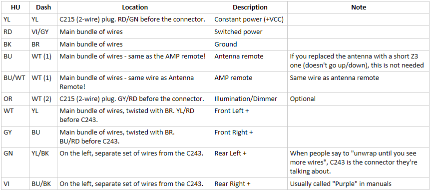

2. I searched the forums for answers on proper wiring. At first I got more confused than when I started. In the end though I think I got it sorted out: connect the positives, cap off the negatives, you're set. Also see reference below.

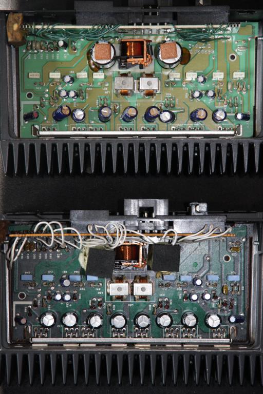

7. I took out the amp from the trunk and opened it up. Because why not? I already spent some money on a new HU, and I'm really not trying to put a killer stereo in the car right now (maybe later), at this point I just want *some* sound without static and crackling. Inside I found three things of note:
a. Some of the wire connections from the main PCB to the back PCB were brittle, and broke when I opened everything up.
b. Pins 1 and 2 on the amp had corrosion on them (mostly pin 1 but it spilled over to pin 2) from the PCB side.
c. The R90 resistor was shot and the wires around it were visibly burnt (not through insulation, but a little bit). The resistor was so burnt that I could not tell what color bands it had other than the last one, Gold (5% tolerance). Some of the shielding had flaked off too.
d. Since the whole thing looked not very clean, had corrosion, etc, I opted to get an another amp.

8. I got another amp from a fellow r3v member for less than $40. It arrived, I plugged it in, no more static at *every level*! However, once I turned the volume up (80%+) I had the same distortion as before, but a bit less. So I cursed a little bit and opened up the second amp. It was much cleaner than the first, no corrosion, wires all good… but… I spied the same R90 resistor bulging!!! It was not as burnt as in my original one, but definitely compromised.
R90 resistor again: This time the resistor was also discolored but the bands were not as bad so I tried to figure out what it was. I tried taking all sorts of pictures (see below) and still had a hard time figuring it out. Eventually I settled on a few color possibilities but that gave me ranges from 0.1-ohm to 100-ohm, so that didn't help.

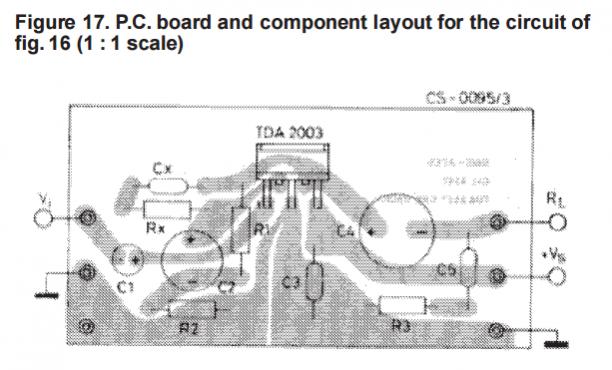

9. I looked at the chips in the amp and found their model: TDA2003 from ST. A google search later I got the datasheet, www.st.com/resource/en/datasheet/cd00000123.pdf
10. In the datasheet there was a reference circuit diagram and PCB layout. I was able to match up R3 from the reference PCB layout to R90 on the Blaupunkt PCB, since the R90 was coming from Pin 3 of the TDA2003 chips, and it led to Pin 18 on the amp connector (ground). This was a 1-ohm resistor, and my most likely candidates for colors were correct!

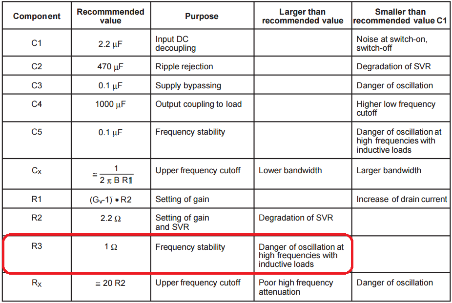

Also datasheet said this about R3:
R3 - 1 Ω - Frequency stability - Danger of oscillation at high frequencies with inductive loads

- "E30 Stereo Wiring For Dummies": http://www.r3vlimited.com/board/showthread.php?t=186210
- "E30 Wiring Diagram Basics": http://www.r3vlimited.com/board/showthread.php?t=246732 - specifically the color codes
