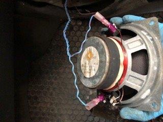

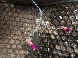

    Hey Guys,
    I searched and thought This would be plug and play, but ran into some issues.
    So previous owner said he added front kick-panel PS speakers, so I bought a set of used PS tweeters and thought I could Install as per info I obtained from searching the forums, but no joy.
    Not sure what is wrong, but it looks like a previous owner did some wiring work. I’m not sure if that is the issue, but I couldn’t get the tweeters to work no matter how I connected them.
    Also, from searching pics of front premium kick-panel speakers, they seem to have a red “capacitor” attached to them, which mine does not have.
    I attached some pics so you could see what I am seeing and maybe give me some advice.
    Thanks!

    The cap is a high pass filter for the tweeters. The tweeters should still work though provided they are hooked up correctly and aren't damaged. Have you tested them? They are easily damaged when the terminal pulls away from the winding.

      How can I test them? And now that you mention it, one of the terminals did pull out....

        Basically you want to break the puzzle down into smaller and smaller pieces, testing each to determine what works and what doesn't. I'd start by verifying the wires in the doors. I used the continuity tester on my voltmeter to test my tweets' wires with no speakers attached. Then I'd turn down the volume super low, take out the mains, and test the tweets on the known-good mains' connectors.
        It's all kinda iffy though, even with new components since our cars' wiring is so old and in most cases has passed through multiple DIYers. Hard for me to imagine a car speaker working with any kind of winding or terminal damage; seems like even if you fix it up, the road will just shake it apart again.

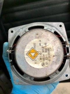

            So the tweeter tested bad. I bought another known good used one. I wanted to double check with you guys to make sure it’s ok to use it without the capacitor on the kick panel speaker. For some reason these speakers on my car don’t have the capacitor (see pic, pretty sure they are premium speakers), and I don’t want to damage the tweeter.

              You should really use them with a high pass filter aka crossover. You can get them cheap nowadays.

                Can anyone send me a link for the appropriate crossover for this application? I’m a audio newbie, don’t want to buy the wrong thing. I’m assuming I can just solder it on to the kick panel speaker?
                    Can you recommend one that will work with the stock PS system? I am not an audiophile, I am just looking to add the tweeters to the system.
