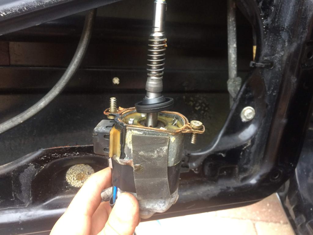

    Title says it all. I've used WD-40, Heavy Silicone spray, etc. and none seem to do the trick. I've read about putting a little bit of engine oil at the base of the motor but seems like it'll be pretty messy, since the motor spins and theres a little hole at the bottom. Anyone have any experiences?
    Long story: So originally my windows would go up and down but in a very rough and clunky manner. I decided to investigate, took all door trim apart and got to the motors, removed them. When I would press a window switch the motor wouldn't "whiiirrrrr" properly. I took apart the little motors, cleaned them, sprayed way too much WD-40 on them and the tracks (car has window tracks, not scissor-style). I tested it and it "whiirrr"-ed correctly for a few seconds but it would just leak out WD-40 from the little hole on the bottom side. I decided to re-install anyway and the motors just wouldn't turn. They click but they seem to be stuck. I could just buy new motors but eh.... Anyone?

    IMHO, Wd40 should never be used on ANYTHING to lubricate. It's simply a cleaner that's falsly marketed as a "lubricant".
    Not sure what to use, but definetly nothing that's a "spray" or is watery in appearance. You want something that's thicker, that won't turn runny out once under pressure or higher summer temps.

      I'd be Inclined to go for a grease.

        Stanley Rockafella e30davie thanks for the responses & suggestions. I'm gonna try some Red N' Tacky grease, will update with results.

          Grease worked perfectly. I dabbed a small amount of grease inside at the bottom, where the tip of the motor sits. Then greased the inner walls, now the motor "whiirrrs" like new :)
