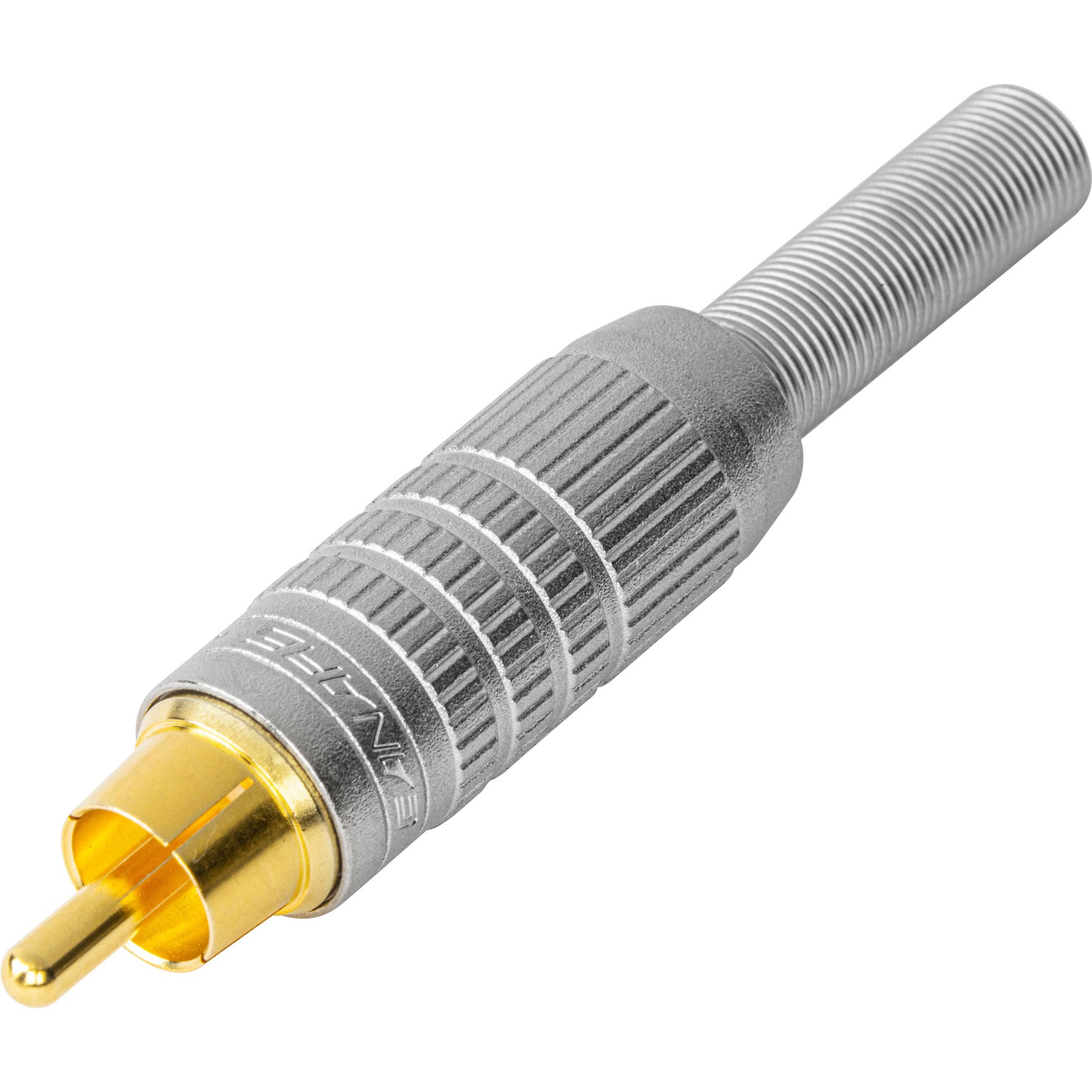

          Also, forget 99% of the RCA cables out on the market, they are almost all trash. The shielding is crap. Build your own from this stuff (this is what I used for my system). The shielding has >94% optical coverage and is braided versus wrapped. EMI has not been an issue for me, at all, and it is extremely durable.
          (I have zero affiliation with Canare or Performance Audio, it's just where I got my stuff from last time)
          2-condutor (twisted pair) cable:
          Black Twisted Pair Microphone Cable with Braided Shield - Sold by the Foot Our standard diameter 2-conductor microphone cable for general purpose audio applications. The high density braided copper shield and two inner conductors (composed of 60 thin strands of copper wire), allow for maximum flexibility and reduced ha
          4-conductor (2 twisted pairs) cable:
          Black Star Quad Microphone Cable, 21 AWG - Sold by the Foot The premier Star Quad cable for all handheld microphone applications. Flexible, satin smooth to the touch and extra strong, this standard diameter, 21 AWG cable fits perfectly in all XLR-type audio connectors. Forty separate strands in each conductor eliminate
          Solder-on RCA plugs:
          RCA Gold Tip Connector with Deluxe Clamp and Body - Solder Type Canare offers in-line cable mount audio plugs in a variety of configurations for the discriminating professional. Each model is carefully designed to accommodate small to large O.D. cables and all versions offer a generous soldering area for easy wiring as
