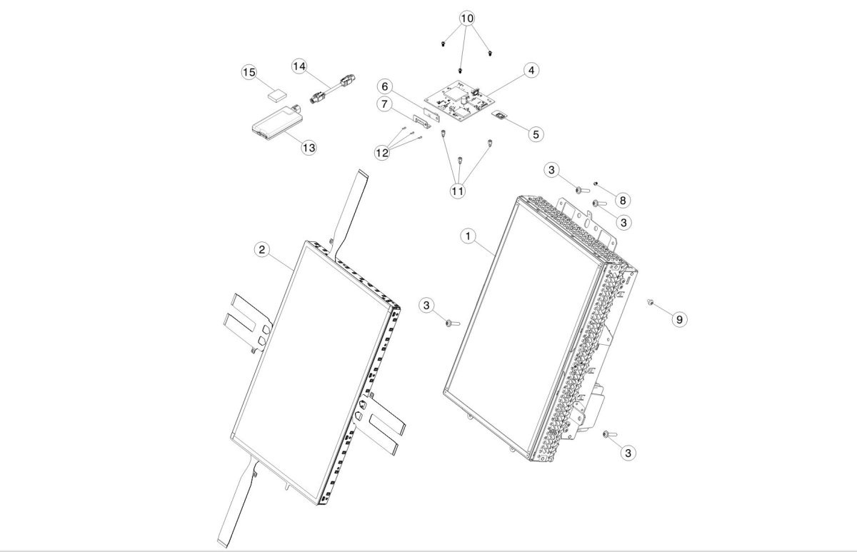

    So I've acquired a 3D printer, a moderate amount of circuit board development experience, and I have a 13 button OBC I can reverse-engineer. I've been brainstorming ideas for a modern OBC alternative for a few months now. It will definitely retain all the features of the original 13 button, but I want to hear from the community. I want to know if you guys want an accelerometer function, possible communication with other systems (head unit, DME, aftermarket accessories like radar detectors, etc.), or if you guys would even think this is a good idea. As far as I can tell, this is uncharted territory and I definitely want to gauge everyone's interest.
    If I can get enough people interested in something like this and enough opinions of what functions it should or should not have, I can start to get some definite details sorted. Let me know what you'd think of this and what you'd be willing to pay for one and with what features you'd like in that price range. There's also no reason that they all have to be the same, either; I could definitely have basic, mid-tier and high-tier units each with more features. I'm not against custom requests, either, since they have to all be hand-made anyways.

        Whatever you end up going with, make sure you use automotive rated parts for the display. Normal LCD displays will not hold up in the 150F+ temperatures, and rapid temperature cycling that occurs inside a car. Just look at the issue Tesla had with the Model S display leaking goo and failing. They went with an industrial rated part, rather than automotive.

          Thanks man! The first few batches will probably be more along the lines of a factory OBC but with a modern display. With more features comes more difficulty and I'd definitely be interested in teaming up if I'm having some issues with more advanced renditions.

          I definitely want to make later renditions be able to interface with both standalones and with head units. I'm not sure if I could squeeze both functions into one unit (would be awesome if I can though!), but generally, there isn't much overlap with guys running standalones and guys who want fancy sound system integration.
          I definitely plan on making the display customizable. I want it to be able to match colors with both the factory orange color of all the dash backlights and with any custom color one might set their aftermarket head unit to display. I have a non-touchscreen variant in mind, I don't know if I can get the button feel just right but I should be able to get the button look pretty close.

          I definitely want to get displays and parts in general that'll hold up to heat. I plan on running one myself down here in Florida, so I'm definitely in a good place for heat testing.
          The final product should hold up just fine in the heat, but they'll be covered by the same lifetime warranty that I offer on my injectors in case anything happens. I'll be personally testing them extensively before they go up for sale, so any major kinks during development will be ironed out. I have both LCD and OLED screens in mind and since I can't find a single thing online comparing the two as far as heat resistance goes, I'll test the two out myself.

              I'd love to integrate both, I just have to actually get started with prototyping to see what my limitations are. That's why this is in the technical forums and not classifieds; I don't want to get anyone's hopes up with promised functionalities and not deliver.
              Anyways, my idea for the head unit integration is to pretty much make it an MP3 player (possibly with MP4, 3GP, WMV, etc. support for videos). The single-din nature of BMWs makes it so we're limited to either having a regular single-din or to use one of the popout units, which I personally hate. The OBC will display the track name, artist, track image, and time elapsed. I want to have a 3.5mm audio jack and either Micro SD or flash drive integration as well. If I can get a good bulk deal on either storage solution I decide on (8gb or more, I'd like to go with 16gb though), I'll include one per unit.

                        I do think there's a small market for OBC replacements that communicate with DMEs and head units, and can flash stand alone engine controllers.
                        I think there's a much bigger market for a DIN standard head unit that does that stuff and does Android Auto. Maybe dual boots Android Auto and Windows 10 so you can just run your engine controller's data collection and flash software natively. Or Debian if you're kinky like that. The new Pi 4s are impressively capable.

                          Hope you don't mind if I just give my 2 cents - ya gotta take it slow....And test, test, and re-test. Also, one of the thing that sucks about making anything for a car is the transient power. Meaning you can see -100(negative) volts on a 12 volt rail(power source) in a car at times. Weird I know!
                          Protecting from that is work, with double, quadruple redundancy. A good diode selection, and a burden resistor will help a butt load. The right regulator made for it will help more.
                          The e30 "innovate goods" dudes got a taste of that, and had to "recall" their product - so test, test, test, and when you think you're done testing, test it some more.
                          For example, before I sold my Interior Light Delay Unit, I set it up on a workbench, and had it cycle 30,000 times....just to be sure, before I sold a single module to anyone.

                            A market to look at might be an OBDII data logger for swapped cars. Of course a dedicated reader like OBDLink with bluetooth connection to a phone with the Torque app is tough to beat for convenience.
                            There's certainly some amount of adaptation that has to happen to read gauges from a number of manufacturers, and you'll need some hardware for that. You may just put your connector on it and include the mating connector pigtail shipped with the unit, leaving the wiring hookup to the installer.
                            Would you be able to put enough processing power on it to run Android, Android Auto or similar? I think the value of a generic display integrated into the OBC location is better than something that only does MP3 track identification, but also a lot more work.
                            Also, check out what these guys are doing in terms of translating back and forth between BMW and LS CAN languages:
