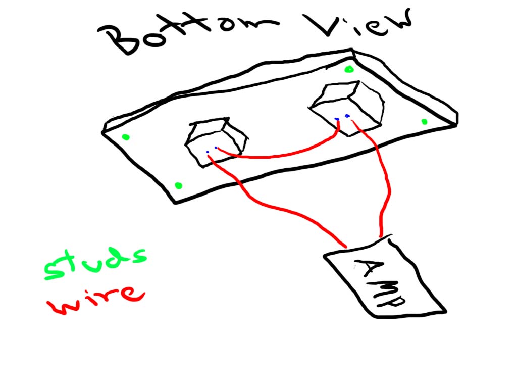

    do what i did in a friends e30... cut out a sheat of MDF the same shape and size to fit above the shelf... cut holes for 2 10s at opposite ends
    cut holes in rear shelf that are big enough to buid a sealed enclosure for each sub get the mdf covered re mount 3rd light.... if you are up for the chalenge it is so worth the end result... just make sure the MDF is able to be securly fastened to the rear shelf
    i used studs put throught the board with holes drilled into the shelf with a thick rubber washer a normal metal washer and a lock nut to keep it fastened down and vibration free
    dynamat between the board and the shelf keeps the ratlles away...
    here is an xample of what i did... the whole asembly can be removed by just unscrewing the nuts and undoing the wires to the amp...
