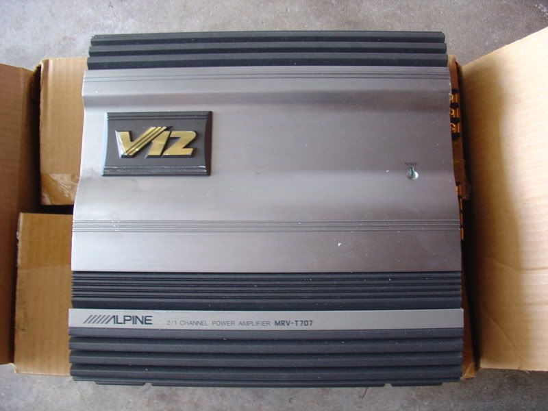

      thanks luke. i may have more Q's along the way. i'm taking my time on this install to get it right the first time. i did a search and was reading on some of the install threads. they said not ot run audio wires with power wires. i'll be running 2 amps and never dealt with a distibution block. should i use one or just buy 2 amp wiring kit? if i go with the 2 amp wiring kit, would i be running 2 remote turn on an connect both to the head unit wire? here are the amps i'll be running. i bought the amps from a friend really cheap and it should do the job for my setup.

        OK, so I would not recommend any amp kits..you are running from the rear battery, yes? Buy 3 sets of RCAs, a fuse holder, 2 feet of 4 gauge and 10 feet of 8 gauge, plus enough ground wire to do the thing.

                Obviously, you will not be using the 5th channel of the 5 channel. It is puny power, and meant for a 2 ohm load, so your 4 ohm sub will only get about 50 watts at most. Your 2 channel will make plenty of power on that sub.

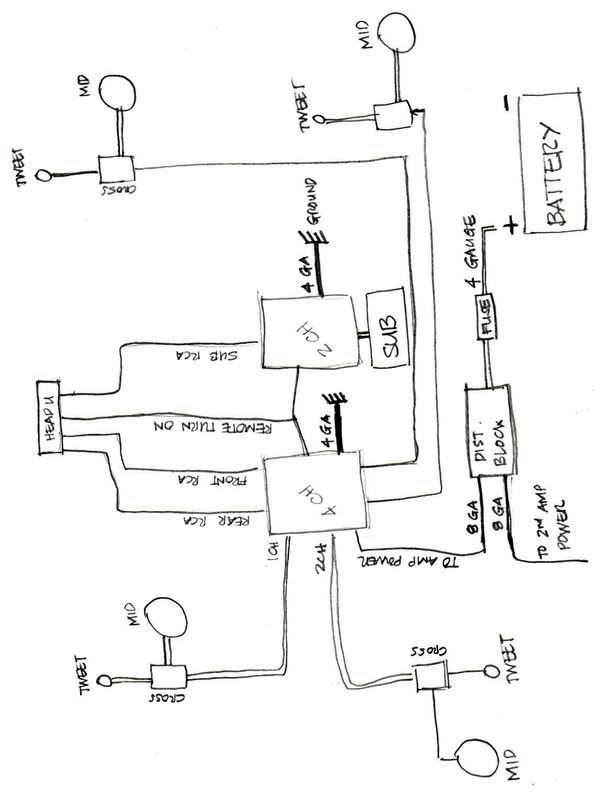

                      i really appreciate all the help you guys have given me. this is the first install i'm doing with components and multi-amp setup and i want to do it right the first time, at least get the wiring done right with room to upgrade the amps later. i drew this setup from what i understood what you guys are trying to say. let me know if this is correct. i also read from cruthfield that if you combine your amp turn on lead that you'll need a relay to avoid burning your receivers turn on lead. do i need a relay or i'm fine here. again thank for all the help you've given me.

                        Dude, you are all sideways! Or, at least your drawing is.
                        My rule of thumb is not more than 2 items turned on without a relay.
                        You would be using "power antenna" to run the antenna, and "amp remote" to turn those 2 amps on. I say no relay is necessary.
                        Neither are 4 ga grounds on those amps, but that is only overkill, no worries.
