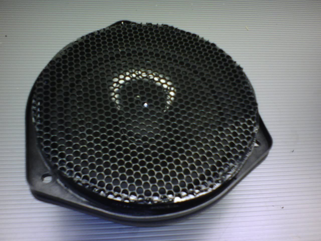

make them! I actually just finished mine at work today.
I cut two rings of 1/4" ABS, acetone welded them together (acetone melts ABS but gasses off in ~30seconds allowing you to form pieces together), then super glue a piece of black metal mesh on the front. I'm gluing the other side of the rings into the speaker so that it fits just around the roll edge but inside of the mounting holes.
Just need a jig saw other than that. -

mmm none as of yet. They are still at work. I'll snap a couple tomorrow if I happen to remember.
You need to make sure that whatever you put on there is tall enough so that the roll edge doesn't hit. A 1/4" wasn't enough and 1/2" is a little too much on my 6.5"Comment
There's no way to get the stock kickpanel to stay on with over a 1.25" ring in the middle of it.
