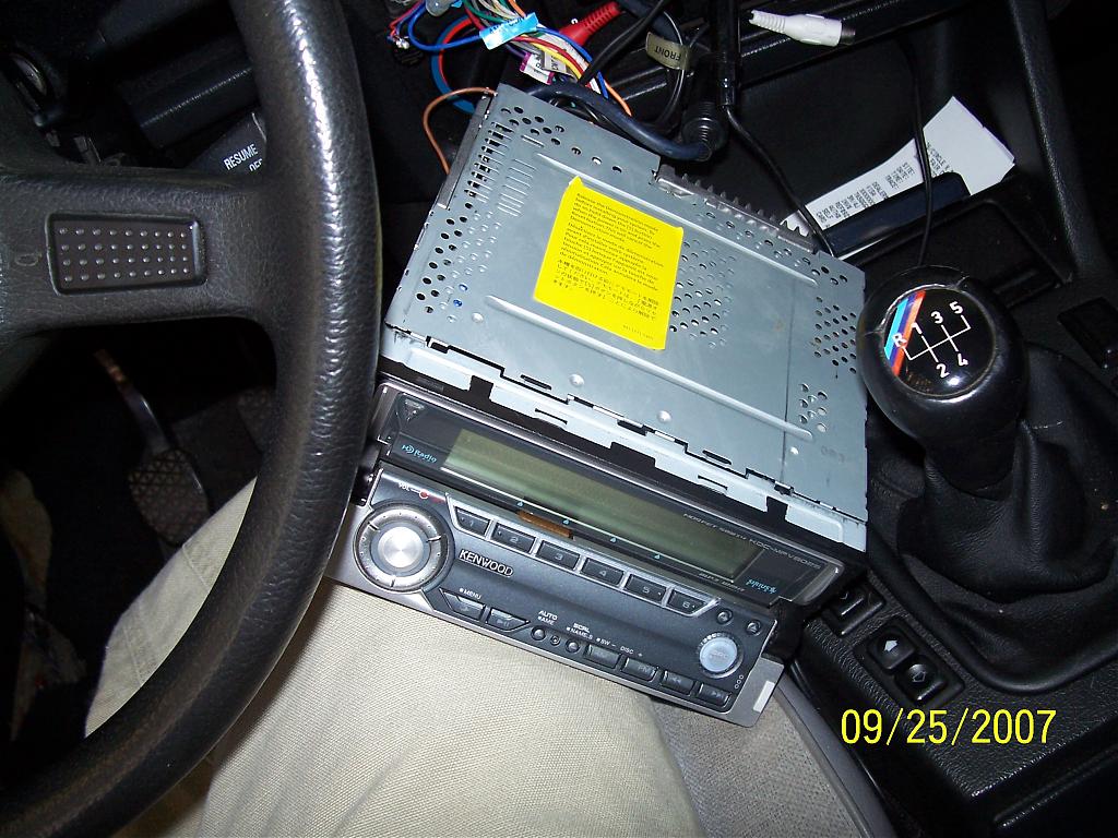

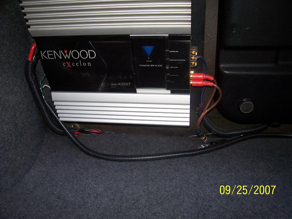

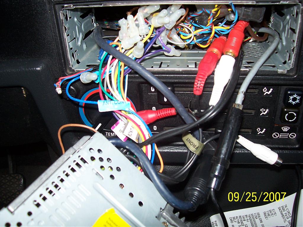

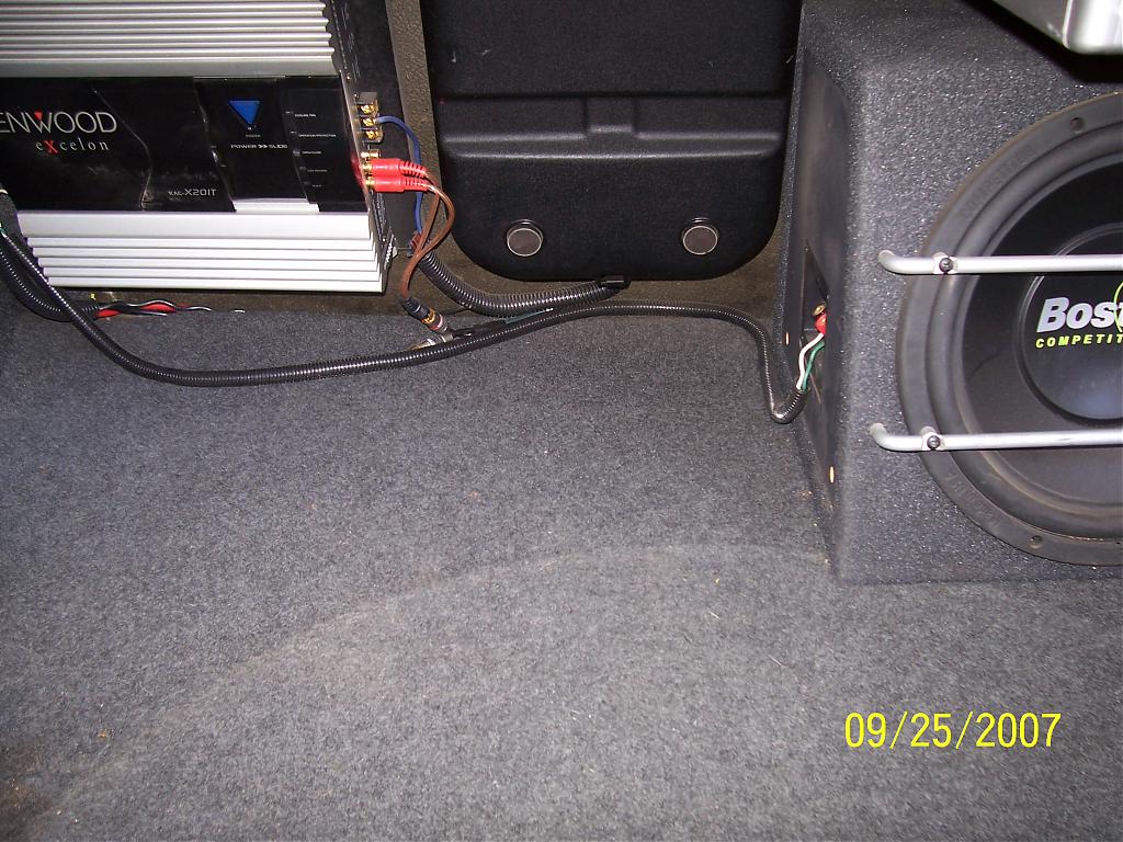

    As far as i remember I can fade the sound from front to back, but with the deck, not that stupid OEM one BMW's have. I took some pics of first the deck which isnt workning now!? I just got in the car the ohter day and the face was still open and it wasnt coming on whem I started the car. I hit the SRC button and it lights up for a second and protrudes out, then back in and off again. I tried to reset it, and even checked the fuse in the back to no avail. A guy here in wown said he would charge $90 plus parts. Seems high but then I dont really know. Then I got a couple of pics of the rats nest wiring, which might make sense to you (Luke). Finally i took pics of the sub/amp set up in the trunk just so you have an idea of what i have to see if anything is amiss there, also just to get your opinion on the components there. Man I wish I had an e30 enthusiast with a stereo shop here in town. Too bad I live in Sac. Anyway let me know what you think, or if you need any more or better pics. Thanks again.

    OK, to start off with, your deck has a major issue. You have broken a "Ribbon Cable", which is a notorious Kenwood issue...and is why they no longer make faces like that. The part is about $15 and is available at http://www.pacparts.com/.
    This little doo-dad is a major pain in the ass to deal with, and I know most techs charge about $100 to get in and change it. I have yet to do one myself, but I have 3 deck with bad cables to fix.
    As far as your wiring, other than the stock wiring not being clipped off, it really is not too bad.
        Luke
        so do you thiunk i should try to change it myself and save the 90 or so bucks or is it too much of a PITA? Or would you recomend a new deck all together? What do you mean about the stock wiring not being "clipped off"? Seems to me the way they connected the wires together with all those little connectors it forms a giant "ball" of wire and plastic and makes the unit hard to cram in the housing with all the other monster cable, disk changer cable, etc. Did you have any opinion on the sub/amp set up in the trunk? I think it could sound better, mounting it in the ski hole, perhaps un-bridging it ? I dont even know what the difference is, but i'm pretty sure it's bridged. Thanks again.

              Fixing the deck is something I have not even looked at, but I think it would be sweet if you did. Order the part, give it a shot!
              It did not look to me like the factory wire was used at all....is it?
                Are there no special tools I might need or anything weird like that? By factory wire do you mean the 8 pin female connector?
                • StereoInstaller1
                  GAS
                  • 22679
                  yep. All of the blue or yellow wires.

                    no, it doesnt appear to be used.

                      Well, I managed to replace my ribbon cable without the help from a crack head, pothead or drunk. But after replacement, the stereo does the same thing. I turn on the key, it lights up, protrudes out, back in, and turns off. Dont get it, any ideas? I do feel like having a drink now though! Thanks in advance.
