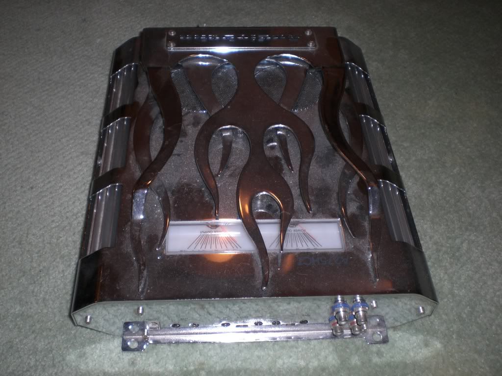

        I got a free amp from a buddy of mine, it's a 4 channel i believe audiobahn amp with a metal flame on top. I'll get a model # but do you think I'll be able to use that or is it a piece of junk/ill equipped to run a sub? I think he used it to run a 14" monster audiobahn woofer, but he didn't set up his own system and I have no experience with subs, so I have no idea if it was appropriate or not.
        Here's a picture of it actually. I'm not at home, out of town for a few days or i'd obviously google the part # to get specs, but if anyone recognizes the amp and can tell me something about it that'd be awesome
        here we go:
            http://www.sonicelectronix.com/item_...n+A275HCT.html
            Done.
            Beaux
            • StereoInstaller1
              GAS
              • 22679
              Originally posted by Beauxsxm
              "Done" what? A big 2 channel pile of Audiobahn? Worse amplifier design is hard to find, even from China. Completely sloppy power supplies, piss poor regulation, just big sloppy power, unable to do anything besides giant sloppy boom...until it blows up and Audiobahn won't fix it.
              The absolute worst customer support/service ever found in this shitty industry...fuck audiobahn.

              • Beauxsxm
                • Sep 2006
                • 54
                I googled the part number from the pic for the OP.

                              Thanks Beaux
                              I couldn't see the part # in the pic or I would have done the same. Appreciate it though. And I appreciate Luke saying I should be looking for something better.
