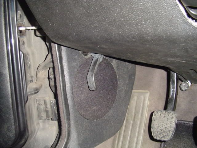

        I did it on my first e30 about 10 years ago and it made a very noticeable difference in sound. However, I do remember having to modify the hood release lever with some washers in order to clear the speaker grills.
          yeah the hood release is your big hurdle. it wouldnt' be hard to move it further down into the foot well either. as long as its mounted to a solid surface it should be fine. I have my 6.5's done that way right now. I think with 5.25's that it would not be difficult at all.

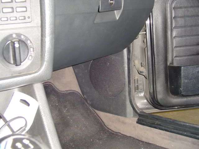

                When I did Jimmys M3, I used a set of 6.5" grilles covered in grille cloth (just the mesh part) and cut the kickpanels very carefully, then glued the grilles in place.

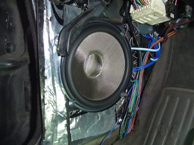

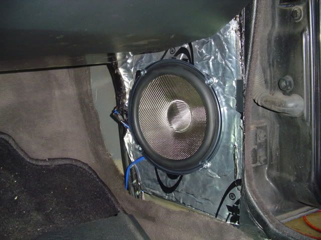

                    Here ya go
                    -Andy
                      thats about how mine are now. I've also seen people use the stock grill holder piece and fiberglass that into the stock panel. came out nice.
                        Originally posted by dashboardmonkey View Post
                        Here ya go
                        What speakers are these?
                          Titanium Power 6.5" components. Awesome sound, great power handling, nice fat midbass...for about $200/set.

                            Did you Dynamat inside the "enclosure" behind the speaker as well and try to seal it off at all? I'm really disappointed with the midrange from 5.25" JL XR's in my car, definition is good, but punch isn't there at all. Even with the Zapco AG 360 pushing the woofer/tweeter as a pair on each side.
                            www.gutenparts.com
                              All the dynamat was already there from a previous install. I don't remember there being any inside though.
