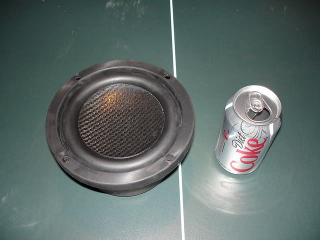

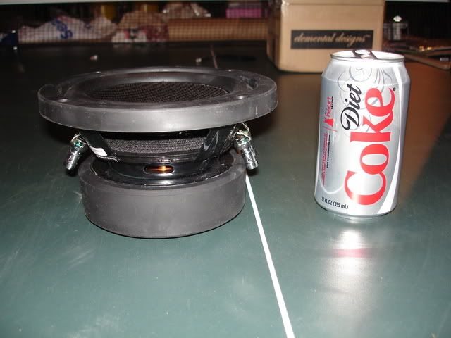

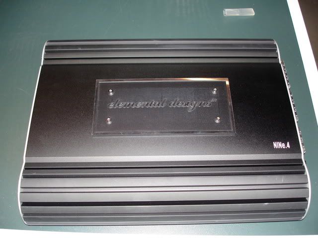

                  Got the ED stuff in today. These 6.5's are bulky! An holy fast shipping batman.

                      The ED stuff looks nice. Did you buy it directly from them?
                        Yeah, right from their website. Paypal'd on Monday, On FedEx truck by Tuesday morning, and delivered yesterday.

                          ED rules, awesome stand up company with great products. They are a boutique manufacture who doesnt wana get huge which is a very good thing imo. I have there 13a3 in my truck and have had 12 k's 10 k's 8a.1's and a whole bunch more and was never let down by there equipment.
