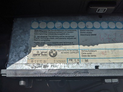

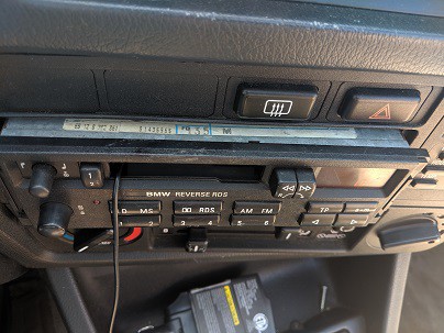

    Sorry for this oddball post, but I've been struggling with this for a while and have run out of options.
    I purchased a stereo unit off Ebay that was supposed to be original, but while I've easily wired it up correctly, it doesn't "stick" in the radio slot. The toothed tabs on the side of the radio don't have anything to stick into... it's as if I need a bracket for the car. Maybe someone with an original stereo could inspect their setup and let me know. I've attatched photos of the problem.
    Thanks,
    Alec

    Strange. Looks to be the standard DIN size, so it should fit. Have you tried brute force yet? I see some clips protruding out of the side. Just make sure there's plenty of clearance behind the unit.

      I have, I can push it back easily but there's nothing to keep it back. The first picture shows where it ends up, with the clips hooking into their natural spot.

        Maybe a previous owner has modified the trim panel to fit a different aftermarket radio? They may have enlarged the hole so now the stock radio doesn't snap in.
        Can you post a picture of the side of the radio showing he clip?

          Remove it, and show a clear pic of the cavity it's going into. It's almost like you're trying to force it into an aftermarket radio sleeve?!?!?

            I think the previous owner must've widened the hole like you said... it perfectly fit the previous radio's sleeve, and there's no sleeve in in currently.
