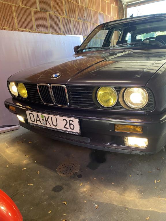

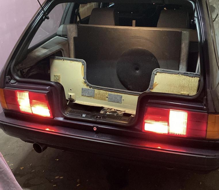

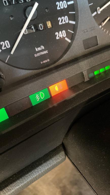

          I checked my foglight bulbs because the fogs were non-op. Nope, perfect. Dang. Removed the switch. Looked great. Dang. I decided to follow the directions here anyway. Boom. Front fogs work and both dashlights illuminated for the first time in my ownership. Now onto the back lights. Checked the bulbs, nope, perfect. Dang. Fiddling with the rods in the bulb holders I replaced everything. Boom! Fronts and rears working perfectly! Thanks a million for this.
