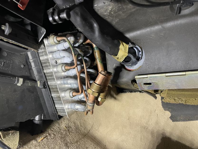

    So as part of fixing one thing that touches on another thing I decided to convert my system to r134a, part of that includes cleaning out all the old pipes and I had hoped the evaporator. But I cannot for the life of me figure out how to get the evaporator core out of the car. I suspect that the firewall on the convertible is different because of the battery placement, but I am not sure. Here is the best I can get:
    You can see that there is a grey box the glovebox hinge is attached to as well as the wires to the ECU. The tutorials all say tip it down and it will come out, but all of the images I found don't look like mine.
    Either I am missing something or this just can't be done this way on a convertible. Help!

    Remove the glovebox hinge. You should be able to get it out around the harness.

      I was thinking that I would need to do that, but I cannot even get that far. I hit that grey bump, I read stuff about angeling it down and the like but I am only able to slide it in and out, I assume I am not getting it far enough out to be able to angle it yet. Do I need to tear all the foam padding out? Would that make enough room? It is fairly fragile and I don't want to break it on the way out.
