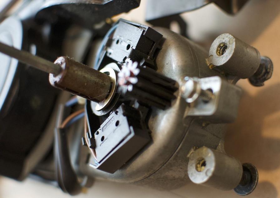

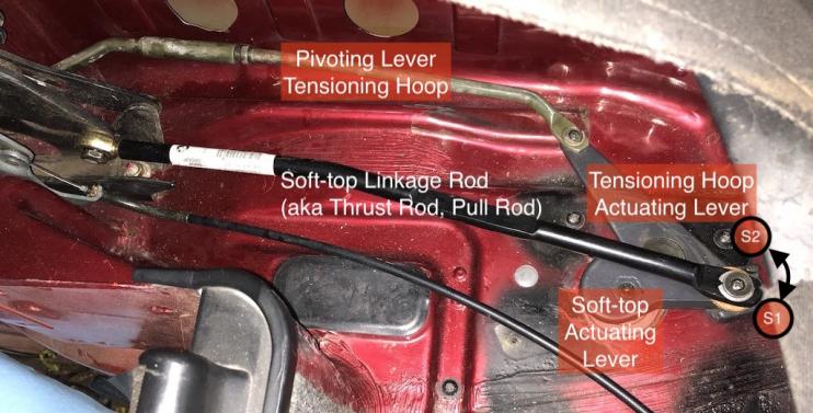

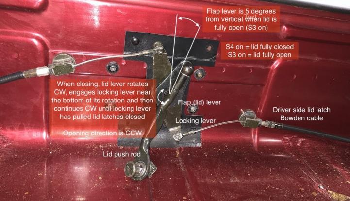

        take a closer look at the top mechanism on the passenger side. There are two levers attached to the top motor. Those are the levers that move the main top and the rear section (the frame of which is called a "tensioning hoop"). Also take a look at the boot lid motor in the center of the top boot. The two cables tied to the boot lid motor open the boot lid latches. The lever in the center pulls the boot lid open and closed. Neither the cables nor that lever have anything to do with the top itself.
        If your boot lid "stops closing early", most likely the S4 switch needs to be adjusted. BE CAREFUL WITH ANY SWITCH ADJUSTMENTS. Your top mechanism will STOP WORKING BY DESIGN to prevent damage if you get things to far out of alignment.
        https://www.r3vlimited.com/board/for...15#post6979330
        Click image for larger version  Name:	42382656885_95c381ec8e_o.jpg Views:	0 Size:	58.3 KB ID:	10066329
        Click image for larger version  Name:	42382657025_a9a5aa7758_o.jpg Views:	0 Size:	56.5 KB ID:	10066330
        These are the S3 and S4 boot lid switches. you access them from the trunk side. There's a bracket missing/removed in that pic that clearly labels the switches as S3 and S4
        Click image for larger version  Name:	42368547041_0640c301f6_b.jpg Views:	0 Size:	54.6 KB ID:	10066334
        Adjusting this stuff really takes two people. The dealers had a special harness tool to help them understand the switch states. I intend to build that tool but just haven't gotten around to it - based on the last few years, I wouldn't hold your breath.
