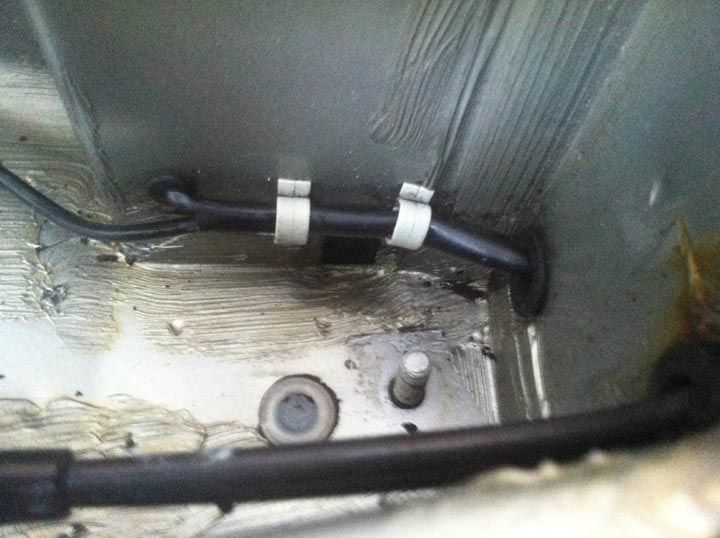

                So I found the drains - thought i'd share. As I said i needed a new top, got one yesterday from E30Jigzaw (thanks for the great deal!) and found the drains while cleaning the compartment during the swap. You'd never find them or clean them without taking out the frame. Here's a pic of the driver's side with the frame removed and all cleaned out:
                The drain is the square black hole right in the middle of the pic with the cable running over it. The bolt a bit to the right is the forward bolt to secure the ragtop frame.
                This entire area was covered in sludge. Cleaned it out, pulled a nice big lint ball from the drain (including a bunch of drilled out rivets from when the PO replaced his ragtop %^$^%#!!) poured a cup of water in, came out the bottom of the car. Good times.

                  I've been having the same leak for about a year. Couldn't figure out what it is. It would leak in there. Spread to the trunk and rear floor boards. I have a good top and also replaced the seal for the lid. So definetly gonna check this drain and hopefully that is the issue. Is it possible the drains at the bottom are clogged as well?
                    Any drain can be clogged but I honestly do not think water should be getting in there and that those drains are there "just in case" and should not be relied upon

                        Ya it's water everywhere while parked. I checked the drains. Pulled off the soft top today (needed to realign it anyways) and it was so dirty in there and the drains were more then plugged. Also found that there are holes throughout the boot for te top and the seals or stickers or whatever where all punched through and that's where water was leaking to the interior and the trunk poured a bunch of water in it after sealing all the holes and cleaning everything and there wasn't any water going to the interior or trunk. All of it gushed out of the bottom. Thanks OP for starting this thread. This helped a lot. That leak was the most annoying thing about my car!
                          This was absolutely the source of the leak for me. It took on a lot of water when parked. I don't have pics, but at the front of the tonneau cover, between the cover and the body trim to the front, there is NO SEAL. (You can see the area in Jeff's picture above, where the trim on the body stops at the tonneau cover). Water just drips in. This is right above the drain too, so if the drain is working, the water goes straight out. Confirmed with a garden hose test as well. No water in there since I cleaned them out.
                          Timmyr77 - I think they probably could be clogged at the bottom too. When I was researching it seems that this happens a lot on sunroof drains.

                              The bottom wasn't clogged at all. I took out the rear interior to check and in the borrow. Water came out fast and cleab
